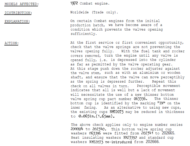

Then from the service sheets (it's number 3 in series 2) see www.eurooldtimers.com/functions/get_file_manualy.php?id=3506
Service Note N2/3 'Combat valve springs'
This issue is also covered in the INOA Tech Digest (pages 1-7 & 1-8).
So with your engine being in the 209xxx range and assuming all parts are standard then this service sheet would indicate that insulators can be applied to all valves on later Combat engines.
Adding the insulators to the inlet valves will almost certainly improve spring life.
It's your decision and if you do fit insulators to the inlet valves then I'd definitely do the check suggested in the service sheet for peace of mind.

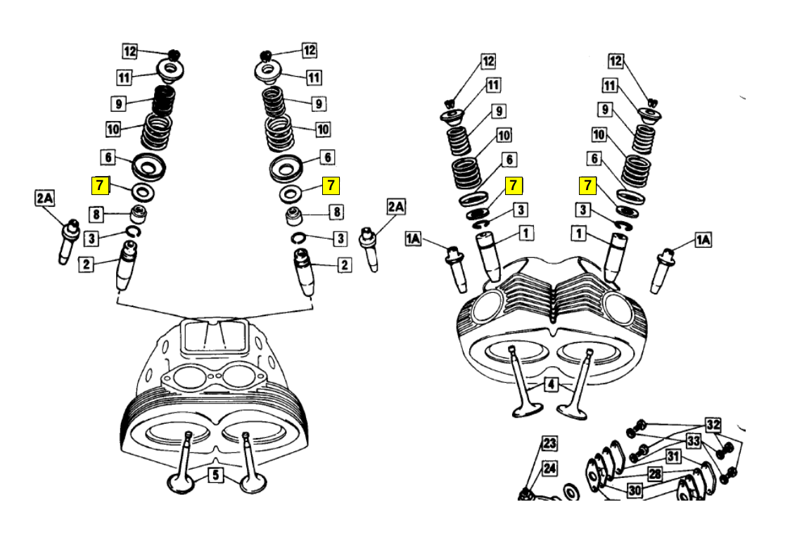

This from parts list ref 065034 which covers late 750 (after 212278) and 850 up to MkII:
From 065034 parts list showing inlet and exhaust valve insulators
'7' is heat insulator NM23392.  From the earlier post it looks like the insulators were only left off the inlet valve spring seats for a range of 750 Combat engines as 'standard'.
