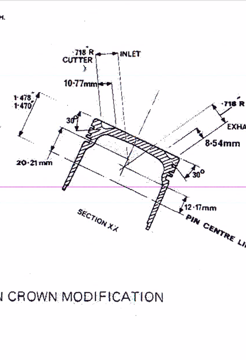

No i didn't know the pisons needed pocketing. Don't really understand the drawings so expect more questions - thanks
Uh - Oh - There's a reason why I couldn't understand the piston drawings - someone has re-drawn them incorrectley - there are multiple errors
