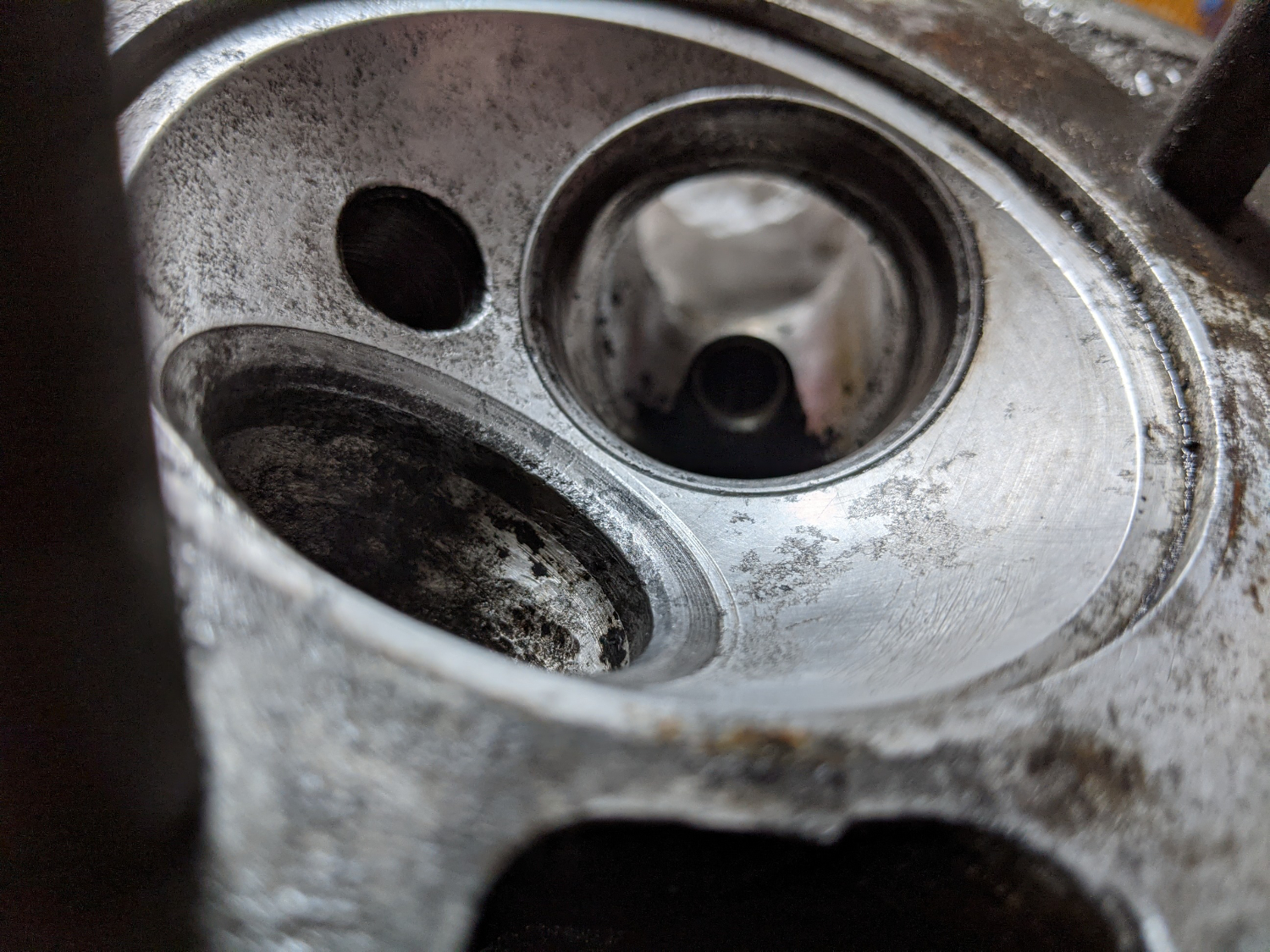

I appreciate it is difficult to offer advise based on photos - however....
1. Why are there areas with texture like orange peel and is it OK for me to carefully polish this out?
2.  Does one think the pitted seats can be restored with grinding paste?
Polish the orange peel out, I no longer grind in seats but use Neway tungsten carbide seat cutters. The finish they give does not need any further work so the valves are not worn away by grinding away on the seat.

Hi John thank you for your reply. A cutter may well prove to be the right solution, however should I go that route I will use a specialist; I wouldn't be able to justify the cost of good cutters! In the meantime I will have ago with some paste. Cheers1
What is the history behind this cylinder head/? My impression is that it has had some corrosion occur and that has given the combustion chamber/cylinderhead gasket face the 'orange peel' appearance.
By all means try to lap the valves in. You will soon see if you are wasting time. A pass with a valve seat cutter will speeds things up.
Clean the inlet/exhaust ports up, combustion chamber as well and lap the head gasket face flat but  don't bother to polish the 'orange peel' out of the head, by the time it has got a layer of carbon on it, it will look the same as any other used head.  Plus polishing material away will lower the compression ratio!
Worth trying to recover the seats fitted, might take a little time and elbow grease but worth a go.

Thanks Ashley,  quite right - elbow grease! I understand the width of the seat face will increase however - if I'm correct -  this will only serve to disperse the heat better?  All else fails then the seats will be cut or replaced. Based on the feedback, I have decided to leave the original guides as they are only 15k miles old. I will polish the awful factory finished exhaust ports to improve flow.
