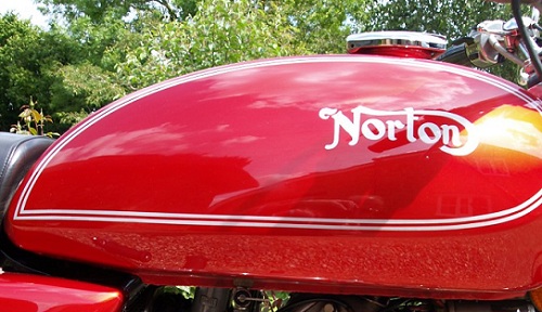

Found this picture on the internet and the stripes do look about 1/8 (3mm) but can really decide what size the gap is....bit of an optical illusion going on!! Mark, how does this compare to your tank?

My Mk2A Interstate has two pinstripes on the (Black) tank - the gold pinstripes are 3mm wide with a 1mm gap between.
