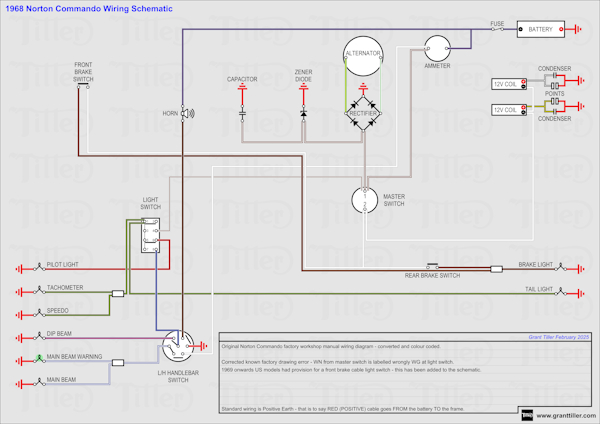

1968 Norton Commando Wiring Schematic

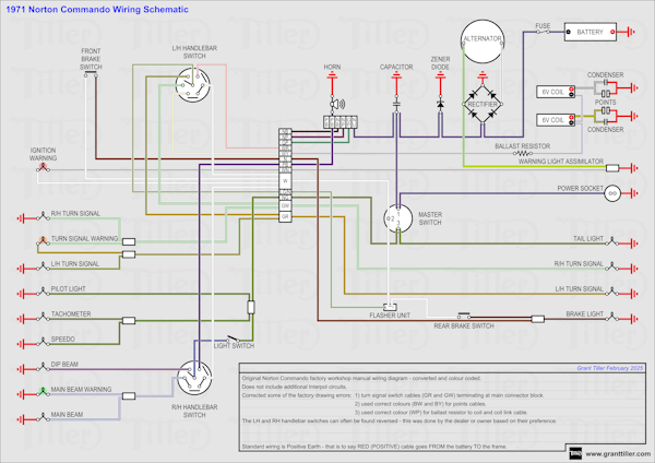

1971 Norton Commando Wiring Schematic

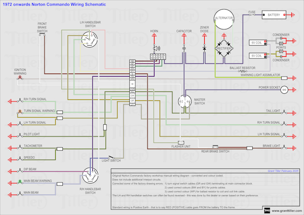

1972 onwards Norton Commando Wiring Schematic

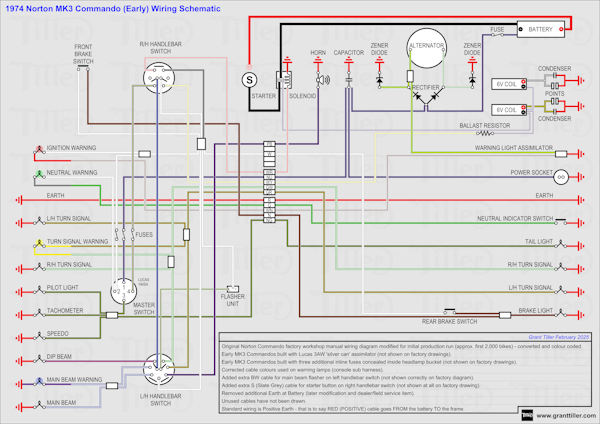

1974 Norton MK3 Commando (Early) Wiring Schematic

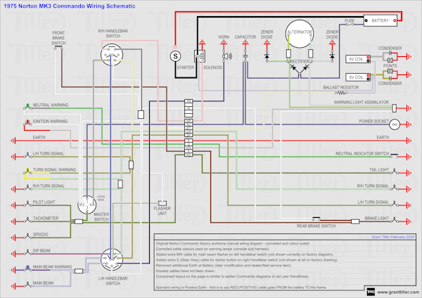

1975 Norton MK3 Commando Wiring Schematic

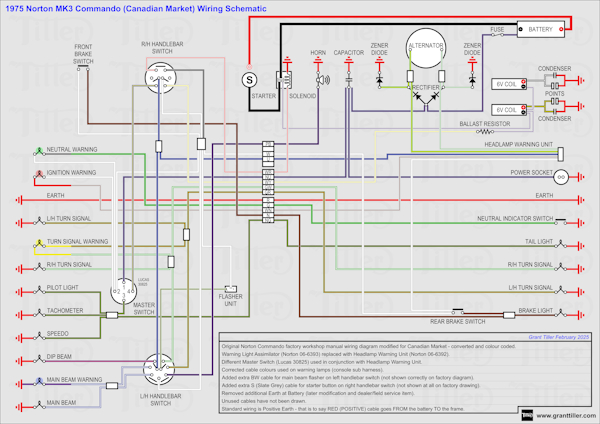

1975 Norton MK3 Commando (Canadian Market) Wiring Schematic
