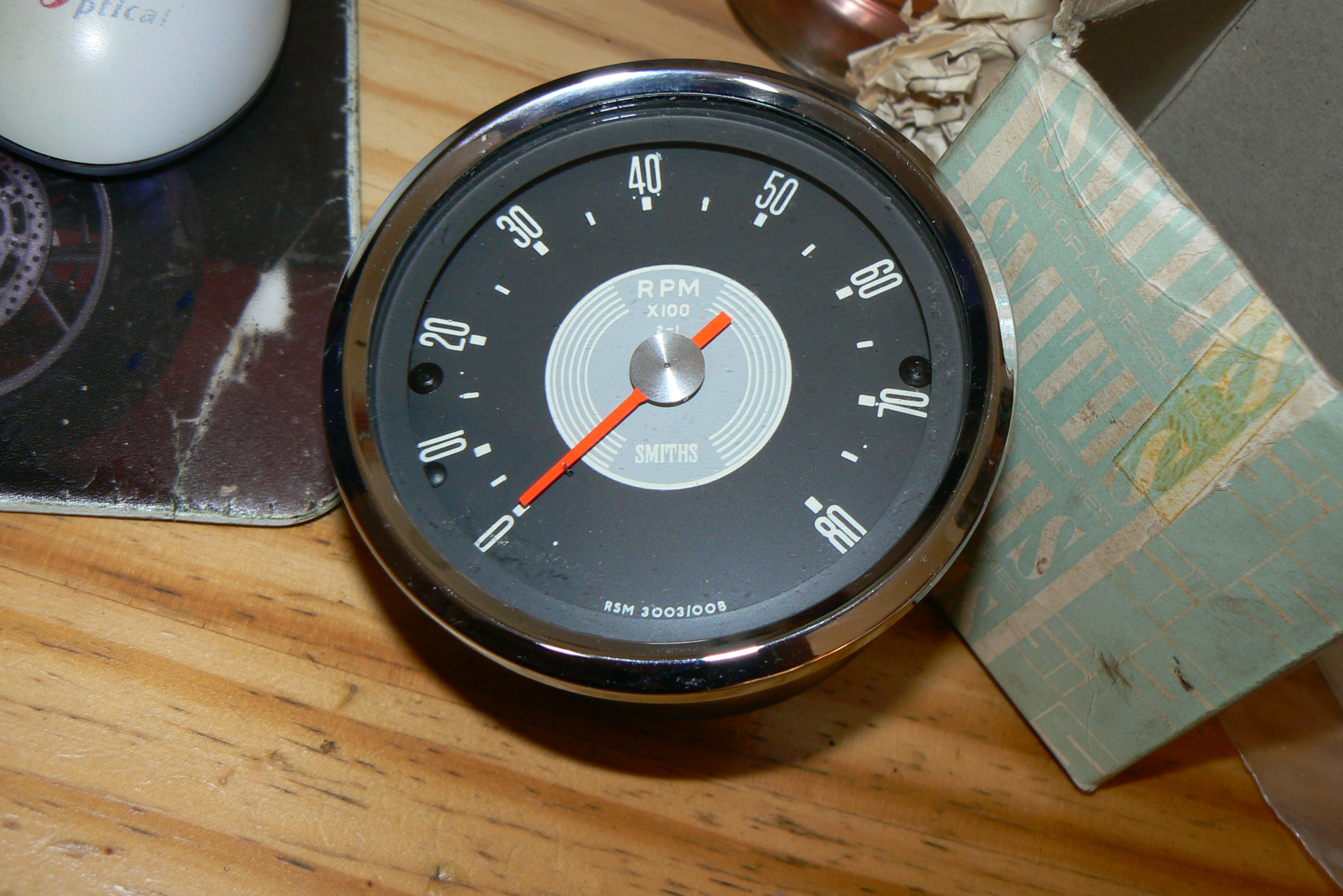

Hello I have 650 SS year 1964 and I have this tachometter RSM 3003/00B i want to buy tacho drive.
which type to choose? and whitch turn?clockwise or anticlockwise?
shaft on timing deckel turns anticlockwise
Thanks for informations

hello Leonard on clock is writen 2:1 it is on foto on my first text. And on your clock is what ration writen?
To Anthony thanks for info, electronic i dont want i have a clock magnetic original on foto in my first text.

If the clock is 2.1 then the rev-counter needs to be a 1.1 drive.

I had to fit a 1to 1 REVERSING Tacho Drive to my 650SS. The drive is taken from the camshaft nut, which is 1/2 engine speed (2-1 reduction) and is anti-clock wise.

You are right today i was in garage and turns engine and now i know that shaft nut turns once and engine turns twice, thats make 2:1

The rev-counter you require was as supplied by Smiths which was BG1508/05. This was a 1.1 drive with a 2.1 head. This rev-counter was also used on the all the later 750 Norton twins. Try to get a genuine Smith one, (this may be a tough ask) as the pattern ones can leak from the timing cover joint and the part where the cable screws into. I had one of these pattern ones, and I found a Smiths one, and all the oil leaks went away.
