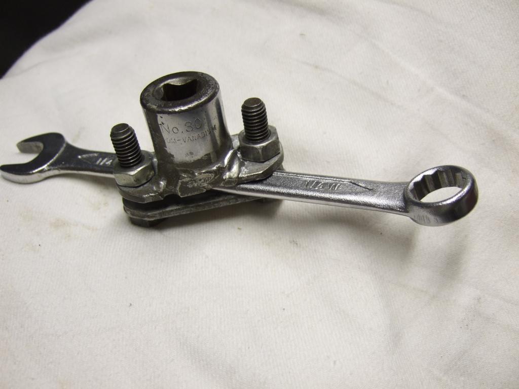

I made an adaptor to use any spanner with a torque wrench as in the picture. If you position the torque wrench at 90 degrees to the spanner the torque setting will be correct. Although for many years I didn't use a torque wrench on Norton cylinder heads and didn't have a problem.
Ah but, as soon as you use this gadget down the spanner for the torque wrench you need to factor in the length you are away from the nut you are trying to do up. Yes you have to be at 90 deg, but the distance away is also critical.
All the Bracebridge Dominator were built without the use of a torque wrench.
It was only when Commandos started being thrown together that these gadgets became part of the assembly tool set.
You can purchase adaptors such as 'Crows Feet' to use for nuts / bolts in hard to reach areas.
Or do as Ian has shown add a spanner to the wrench nut. The problem with this being that you have to allow for the extra length of the addition.
