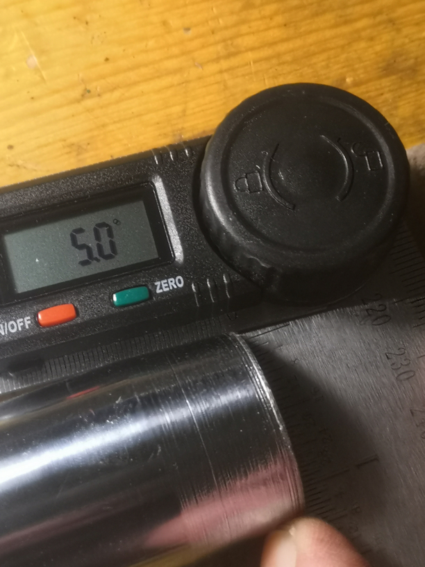

Hello,
Cant' find that anywhere and AN is afraid I'll begin doing some business against them if they gave it to me.
I measured 8°36'.
Could somebody confirm that please.

I don't really understand how the goal could give the right angle, but if you think it might help, here it is:
For my project, willing to keep the original lower and upper yokes, I need longer fork tube. I need to extend the fork tubes and to have the same cone at the end. To fit the top yoke. Hope it's clear enough.

I did the same calc as you but using measurements off the stanchion top not the top yoke and got
10 degrees and 28 secs so 10.5 degrees.
I just went to measure again both stanchions, in mm, and here is what I've got at 10° C in the shed. It came closer to what you had.
RH
Big diameter mm 34,55
Small diameter mm 31,10
Lenght mm 19,07
LH
Small diameter mm 31,16
Lenght mm 18,60
10° and 20 secs for the RH
10° and 25 secs for the LH
Small diameter is not easy to measure accurately and length is not the same on opposite sides of  stanchion but I believe that if we put 10.5° it would fit the top yoke and hold securely in place.
I tried measuring a top yoke and the figures were all over the place, thick powder coating did not help and measuring internal sizes is always more difficult than external ones as you say. As for the stanchion I measured, the depth of the taper was off to one side so I took the average.

The following may answer Christian's question about the stanchion cone angle.
A Manx  Bike specialist, with the actual drawings of the top end of their stanchions, says that 10* is clearly shown in the Factory Blue prints. He also suggests that this angle is almost certainly going to be the same for all the bikes that used Roadholder type stanchions.
