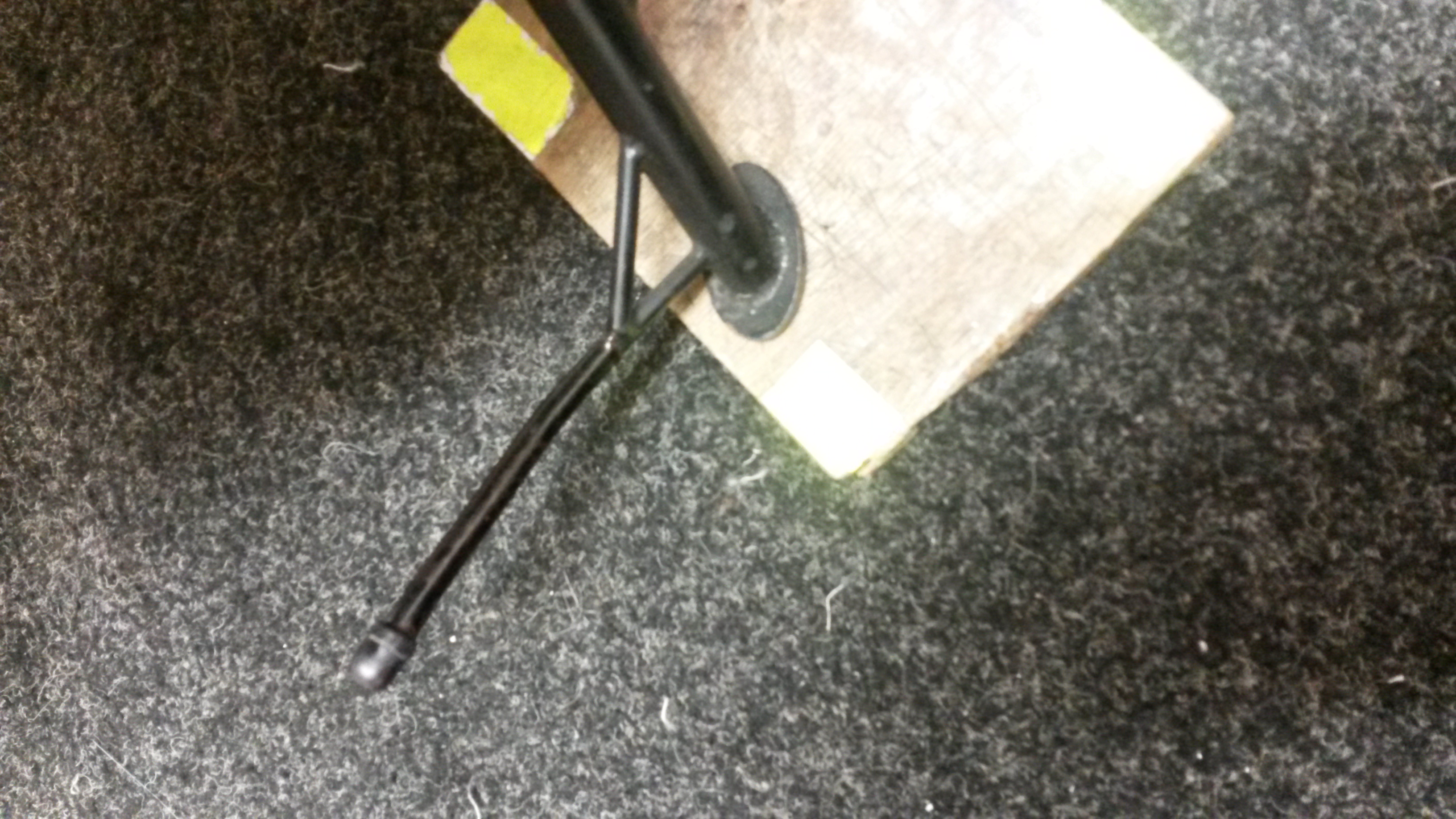

Winkling the stand out.
Anybody have a magic technique to winkle out the side stand when the engine is still running?
I find this nearly impossible. The upright bar needs to be just a little longer.
Simple solution that costs…
Simple solution that costs almost nowt. Get a length of 8mm copper tubing , plumbers have tons of it, then push/knock/bash a slightly longer length over the original tang extending it by 30 or 40mm or whatever length you want. Paint it black then stick a diddy rubber bung on the end ...............hey presto, no more swearing and cursing or looking a pillock in front of a crowd of unsympathetic bikers.
Yeah I did but it fell over ! . :) I think the side stand is just right, why do you want to shorten it ?.
