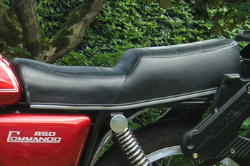

Norman Hyde used to offer…

Norman Hyde used to offer the reduced height Commando seat [see image below] but this is no longer listed. Does anyone else out there still make something like it?
I found it helped a lot, including stopping you from sliding backwards all the time.
