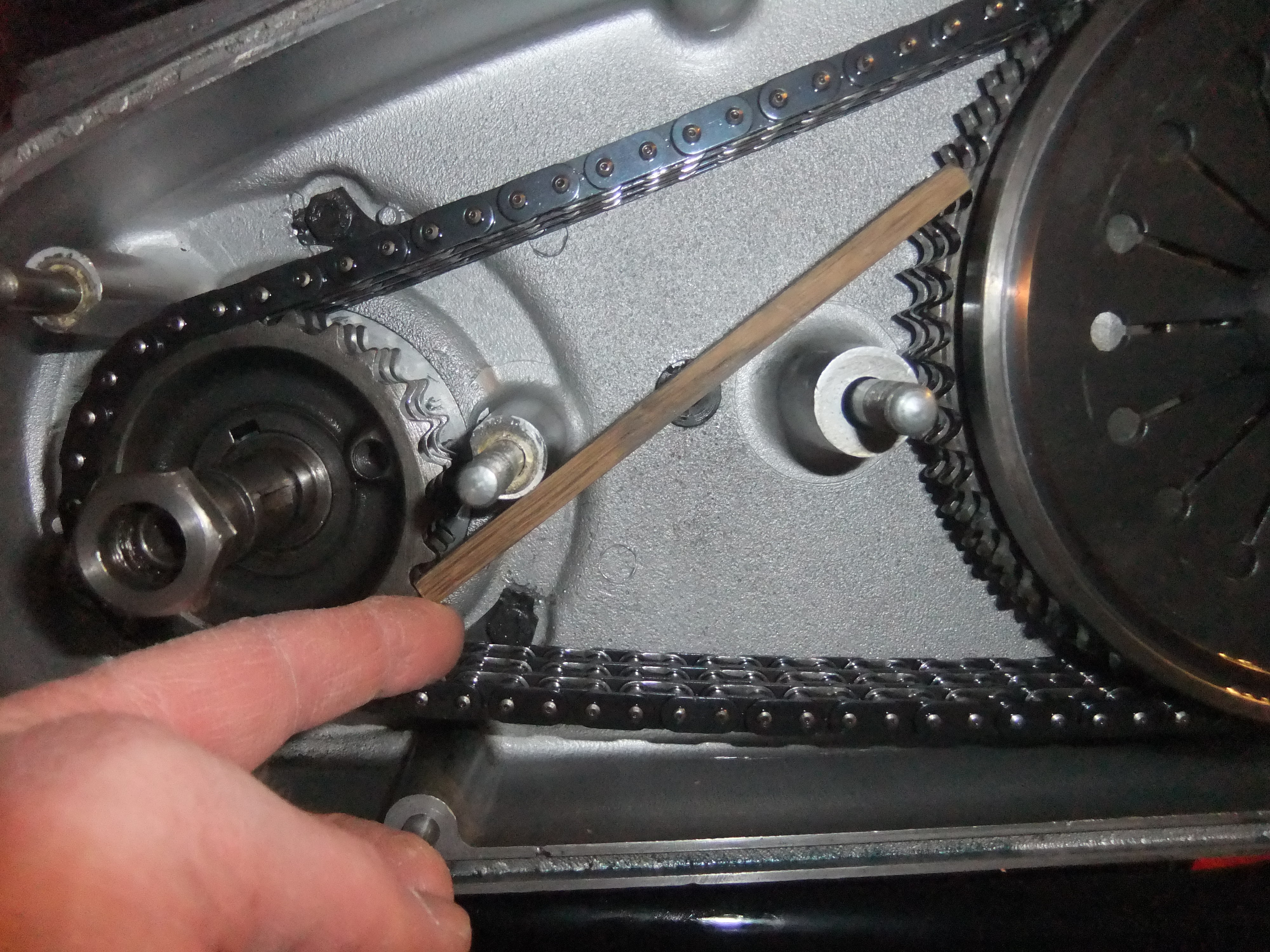

This is how I've done itat the same stage as yours: Put gear lever back on its shaft (fitting outer cover notnecessary), getrear wheel off the ground with blocks under the centre stand , select gear and at the same time rockrear wheelback and forth- should drop into gear.Put rear wheel back on ground.Try your spanner. If rear wheel turnscontinue gear selection until its in top then get somebody fairly hefty to sit on pillion area of seatwhile youadminister spanner.
Another method I've used successfullyto lock primary drive , and which needs to be done very carefully to avoid damage , is wedge a tyre lever with one end in the engine sprocket teeth and the other endbearingon a recess in the bottom of the inner chaincase- Ifeel readers wincing, buthave always managed thiswithout damage to sprocket teeth !
A piece of hardwood betwee…
A piece of hardwood between the chain & sprocket will lock it all up & allow you to remove rotor nut & clutch nut.
A piece of hardwood between the two sprockets.
It worked a treat. Photo attached. Thanks Alan.
PS. 144 x 34 x 12mm
