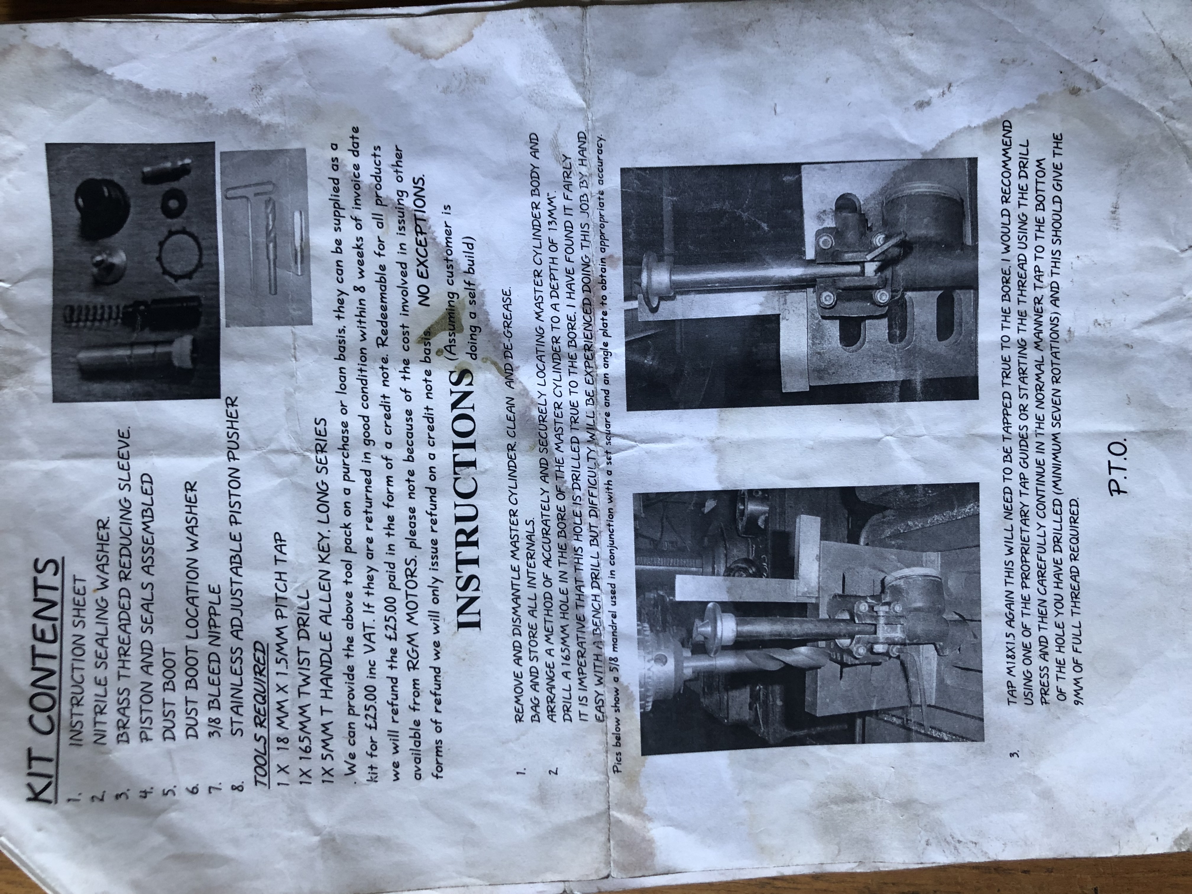

I have attached a photo of my RGM kit instructions that describes how to drill the 16.5mm hole and two the thread - 7 turns in this case, not 8. As I have not yet carried out the conversion, I could not say whether the instruction I have are correct, but why would they not be?
Yours look like more recent…
Yours look like more recent than mine, so perhaps the requirement have been updated? The only effect of drilling to the full depth of the bore would be to increase the amount of fluid surrounding the sleeve, which could be beneficial?
