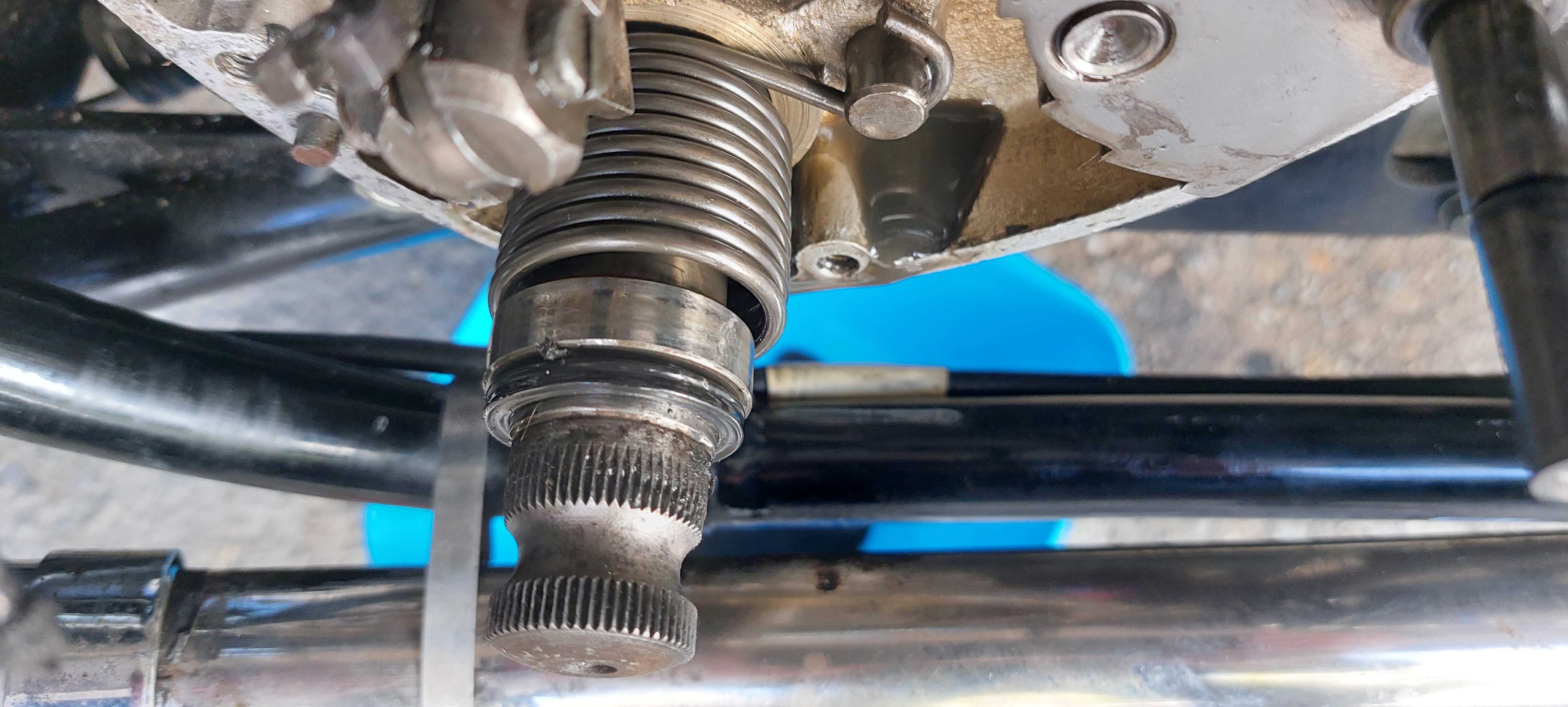

I've just noticed a steady drip of oil from the kickstarter spindle.

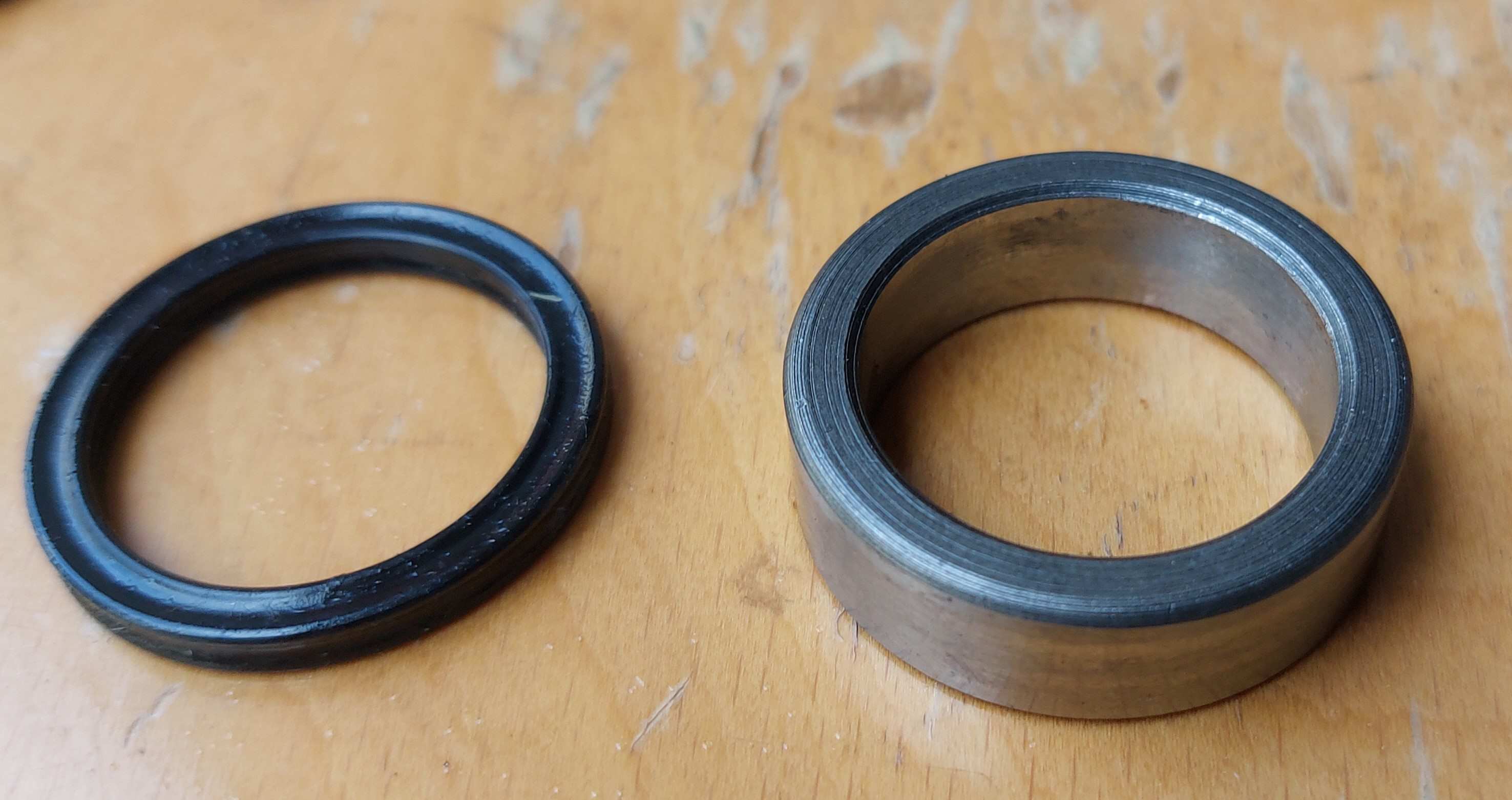

The o-ring and bush didn't come off with the cover but were hanging loosely on the spline, and the bush can be pushed into the cover quite easily - should it be replaced or maybe just stuck in with some red loctite?

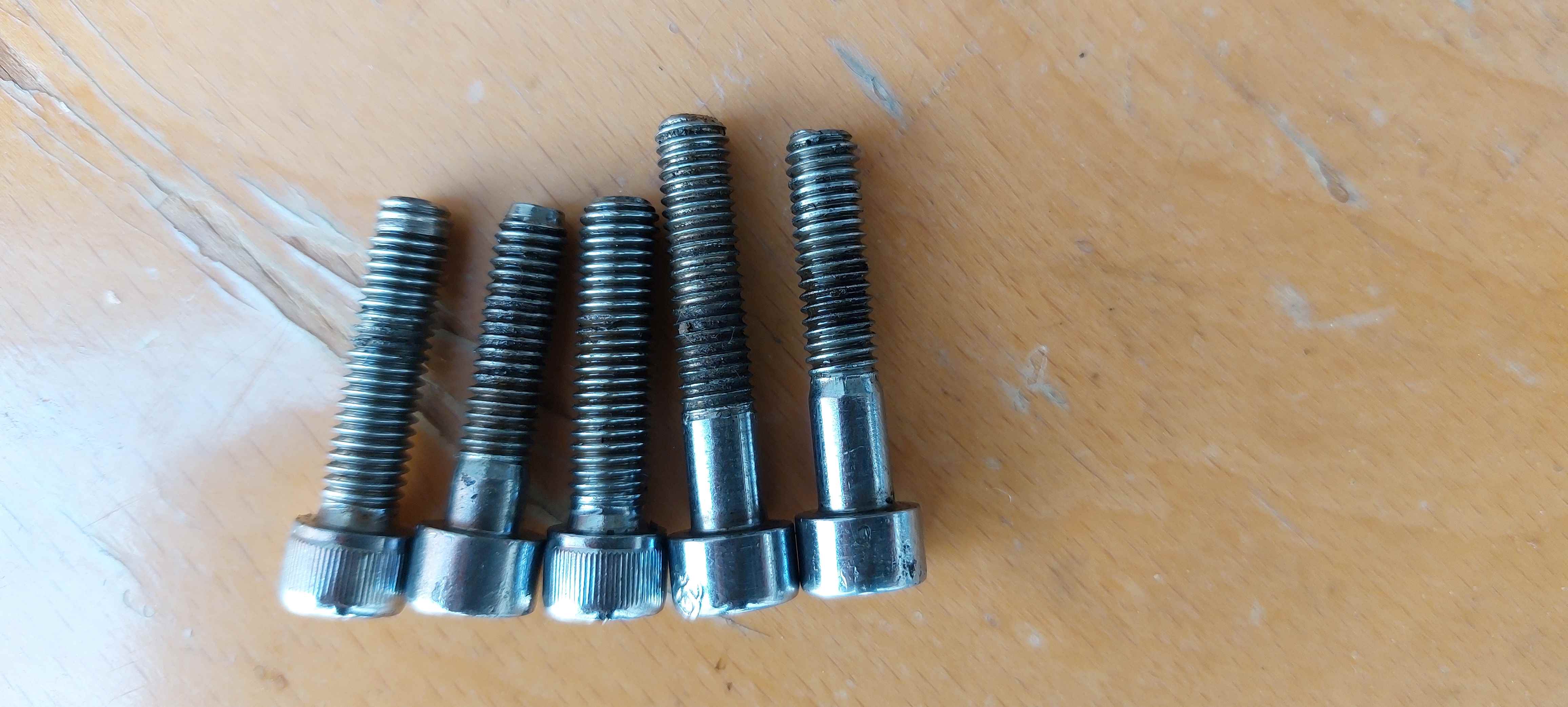

Got round to measuring the bolts. Only 2 are the correct 1/4" linked to above. The others have a 5mm socket and are thinner and the threads are a bit mangled. I guess a previous owner just whacked in what he had to hand.

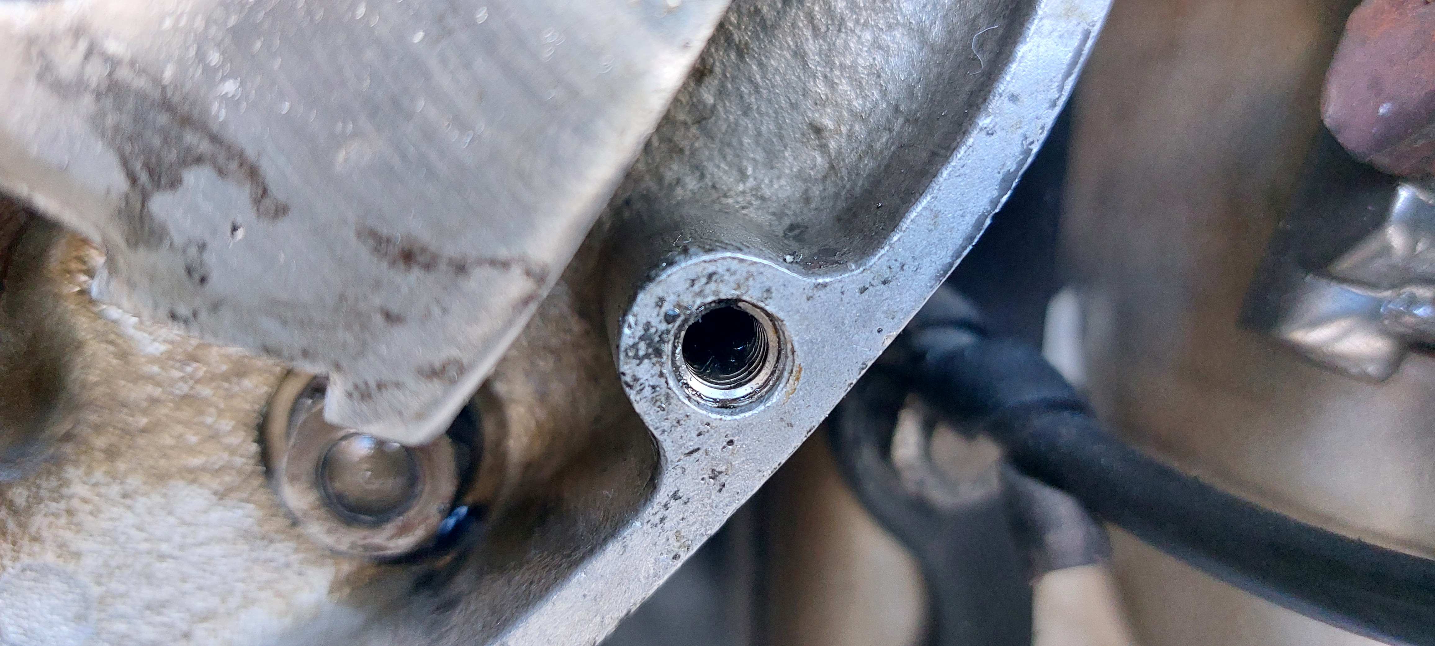

I reverted to what I had: 2 of the bolts are 1/4" and fasten easily, the other 3 are 6mm and also fasten perfectly and it actually looks like inserts have been used in these 3. See photo.

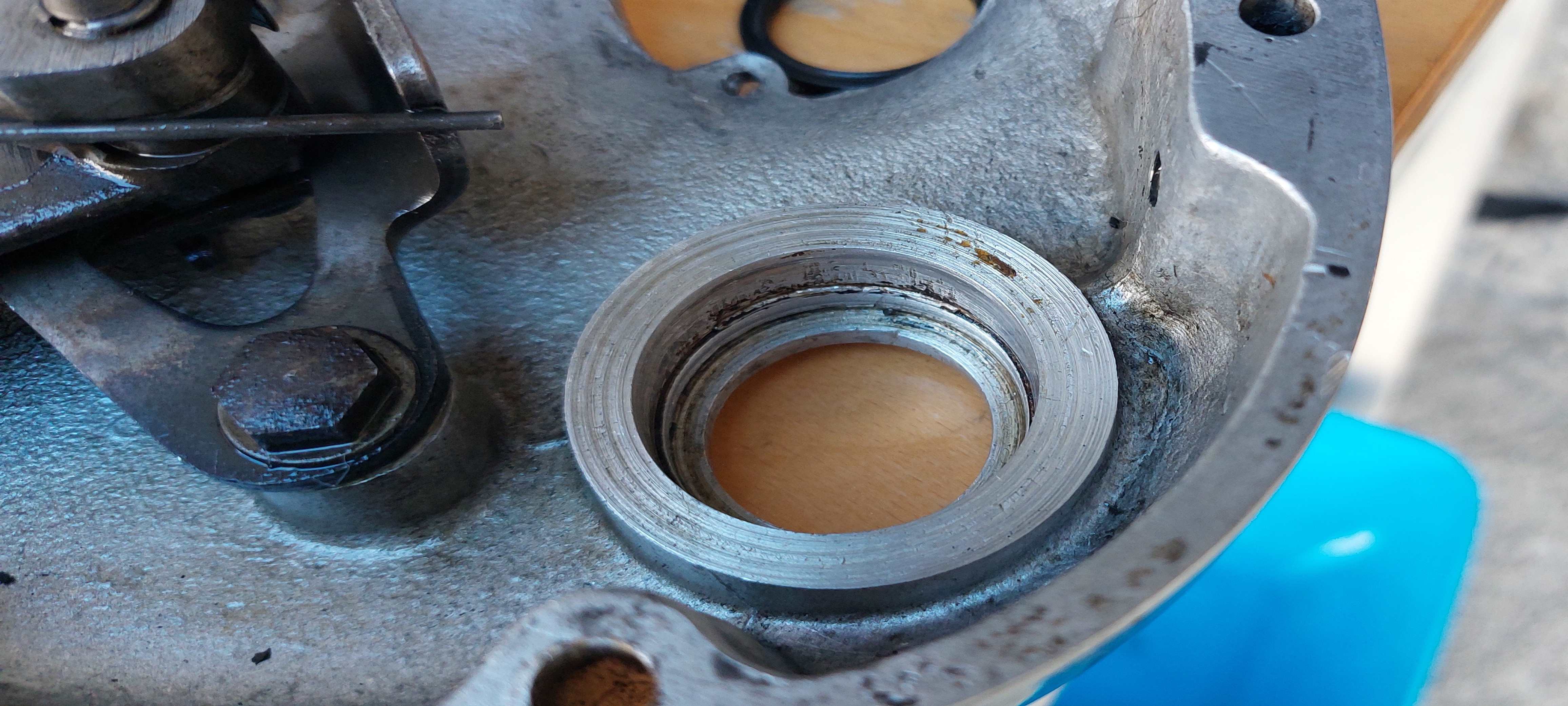

The seat for the kickstart bush is reasonably chewed up, but I put the new seal in and used loctite on the bush. All back together now and no immediate drip of oil. Time will tell.
