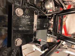

I am at a loss as to the fitment of my rear mudguard, the part supplied is painted black and does resemble the guards shown for the 1970 and interim model commando's on the andover norton site. The rear fitment looks straight forward, bolt nut and washers to the number plate bracket and nuts and washers securing the guard to the fishtail studs via the bracket and rubber pad. The front guard fitment is what is causing me problems, I have had both brackets and spacers supplied by AN and neither line up with any holes in my guard. There is no provision to fit the small square bracket to the battery carrier and the bracket that locates with spacers to the frame gusset behind the oil tank, when fitted does not line up anything like with the guard.

I am rebuilding a Commando at present, so here are a couple of pics of the fender mounting. Top plate attaches to rear frame gusset. Lower mounting point is just below battery tray. Both use spacer washers.
