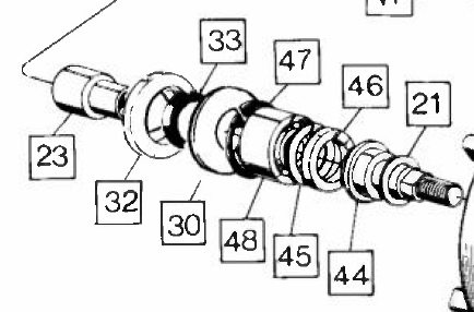

Rear brake drum assembly
Parts book detail
According to the parts book the felt seal at 33 is supposed to be in triplicate (and the AN website offers to add them in threes to your basket).
However, at relevant point in the workshop manual refers to "seal", singular, and only one came out when I stripped my assembly. On the other hand I have no reason to suppose that the last person in there assembled it correctly.
Can anyone offer enlightenment?
I think it means there are 3 of those felt seals somewhere on the bike. So one in the brake drum and two in the rear wheel hub.

Stan's right; looking again at the drawing, the two felt seals in the hub are indeed keyed "33" like the seal in the drum.
