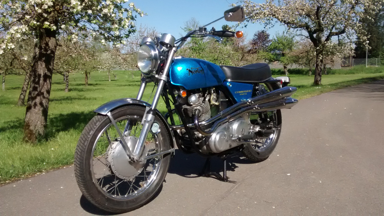

Right! You can use both ex…
Right! You can use both exhaust systems. Here is my 1970 Commando (blue) as a Roadster :
and as a S-Type:

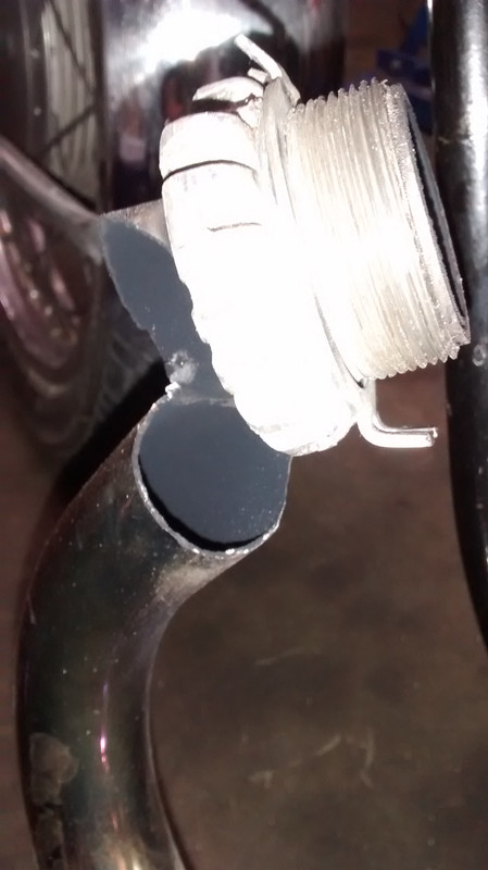

Had to go as a Roadster temporarly because the left S-type header broke.Same bike only different tires and wrong seat, got the original seat later via ebay.
