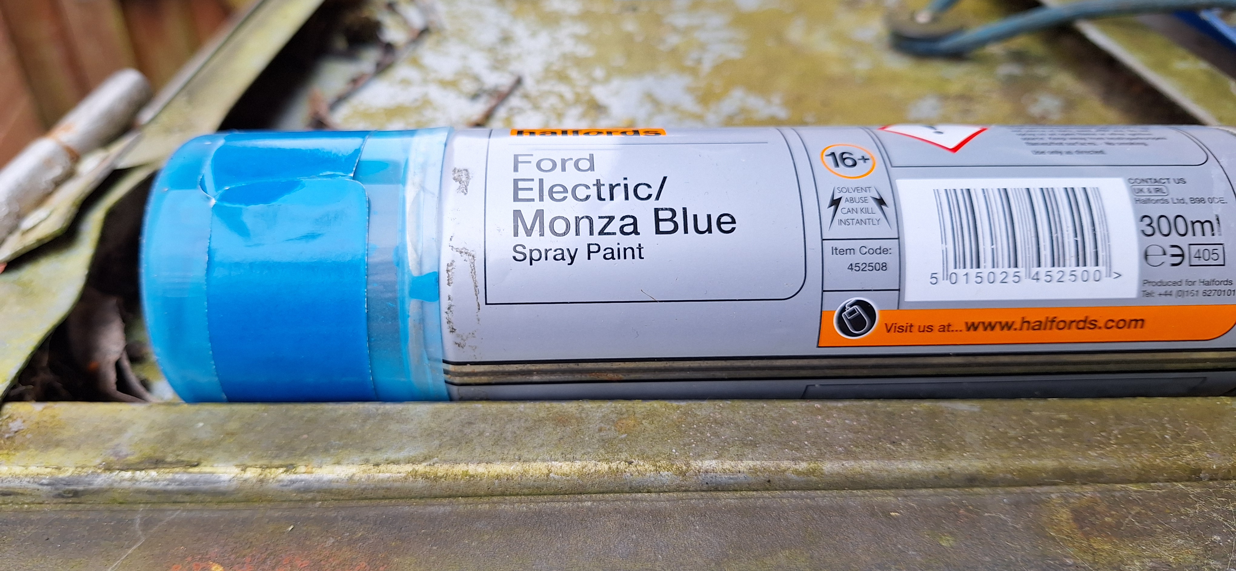

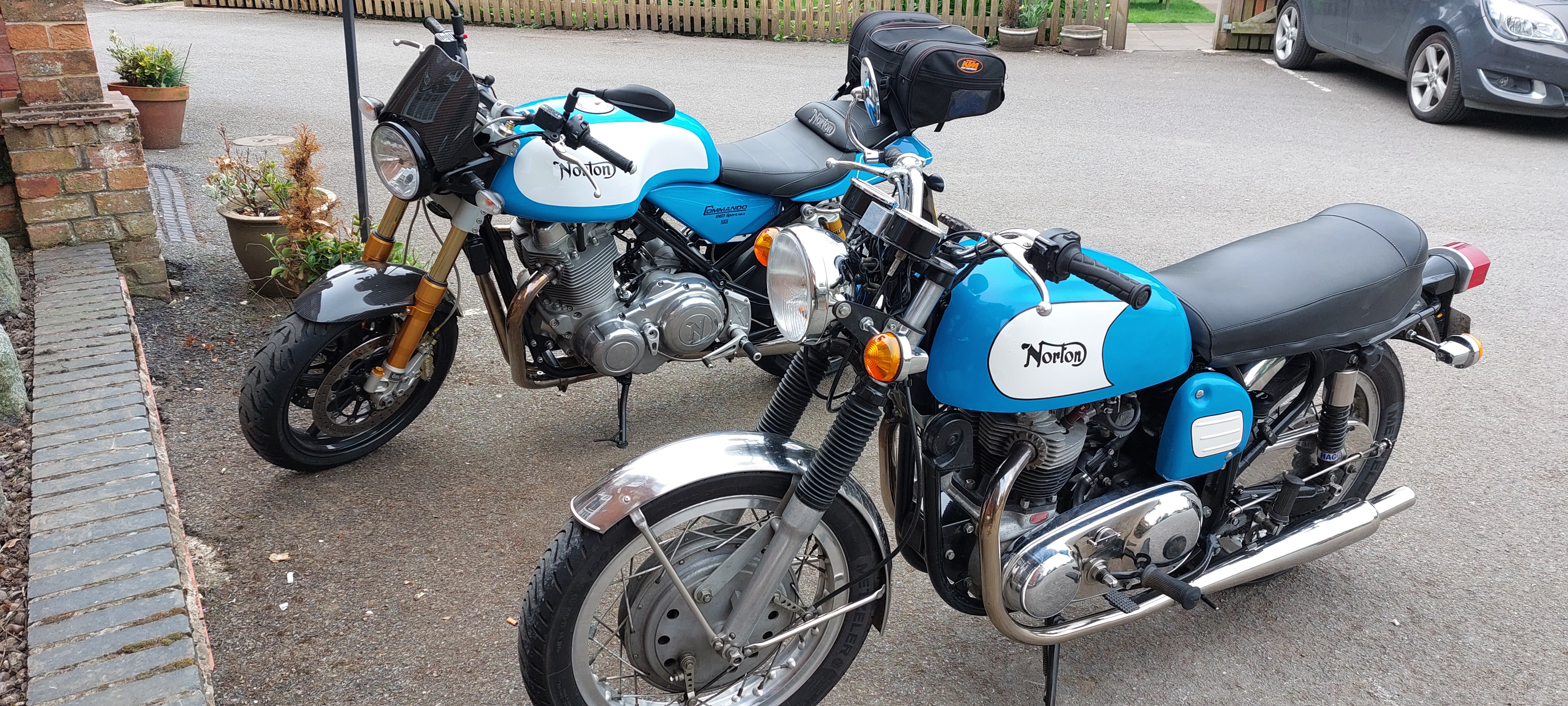

A couple of years ago, when I decided to make my bike a little bit more distinctive I too wondered what colour it was. Wise heads said ask Norman White or Dream Machine as they did the 961 Mick Grant bikes.
A call to Norman and he suggested that it was a Ford colour.
A look at 1970's Ford colours showed one called Electric/Monza Blue.
I sprayed my 650 this colour and I feel it is about 'right'.
I have attached a pic of the can, and a pic of my bike next to a 961 MGR so you can make your own mind up.
