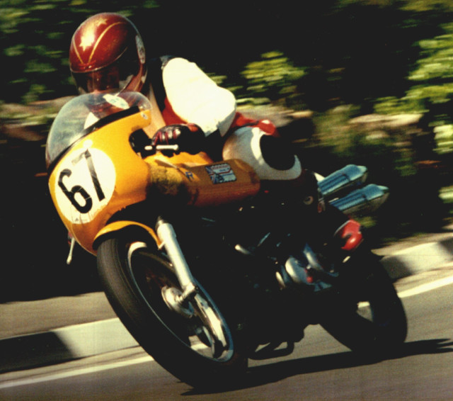

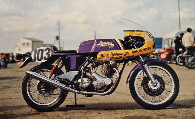

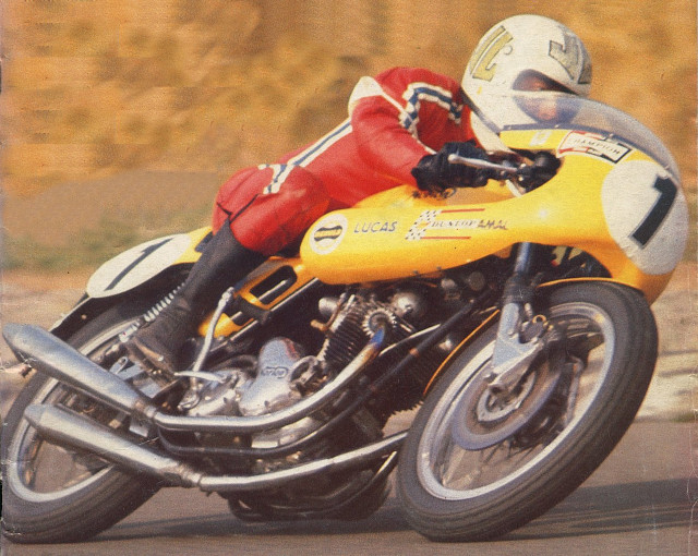

Here are a couple of photos to inspire you:
PR replica
