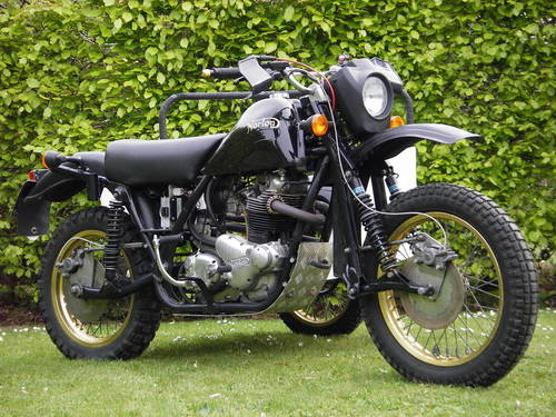

Here is some more info as well as some nice pictures!
Frame:Wasp RT17AZ 1979, rebuilt and converted by Rob Rhind-Tutt whilst Wasp were still at South Newton.Registered Year:1975.Engine type and Size:1975 Norton Commando Mk3 828cc, rebuilt by Norman White Motorcycle Racing Thruxton, inc:Reconditioned gearbox.Belt drive conversion.Mikuni VM36 carbrettor with K&N filters.Boyer Bransden 3 Phase Power Box.

The VM Mikuni carb doesn't have a choke but an enrichment device. It is normally on or off, If you are having to keep it on, ie. enriched, there is not enough fuel getting through at tickover/low throttle settings and the fuel is being supplied by the enrichening mechanism. The popping and banging is typical of a very weak mixture and in your case so weak as not to maintain life. I suggest removing the carb and stripping it down to ensure that the jets are correct and particularly the pilot jet is clear. The correct settings for the 850 with 36mm VM are 240 main jet, 159 P2 needle jet, D6H4 needle, 45 idle jet, 2.5 slide, 2.0 idle air jet.
My money is on the idle jet being too small or the slide having too big a cutaway in it ie. 3 or 4 not 2.5 You can download a tuning guide for Mikuni VM carbs and searching for parts on line should take you to Motocarb. These carbs are easy to work on and very well made the slides and main jets are however quite expensive when compared with Amal parts. Once they are set up correctly they are almost a fit and forget item and will be well suited to your chariot.

Spent the morning stripping down the carb (with plenty of assistance from my Dad) there was no noticable fouling and all the jets were nice and clear. Gave the parts a wipe down with some ambersil fast dry and put it all back together.
She starts a little easier and the pops and bangs are gone, but the fuel mix is still a bit off, plugs are coming out covered in soot and she dies with the choke off.
