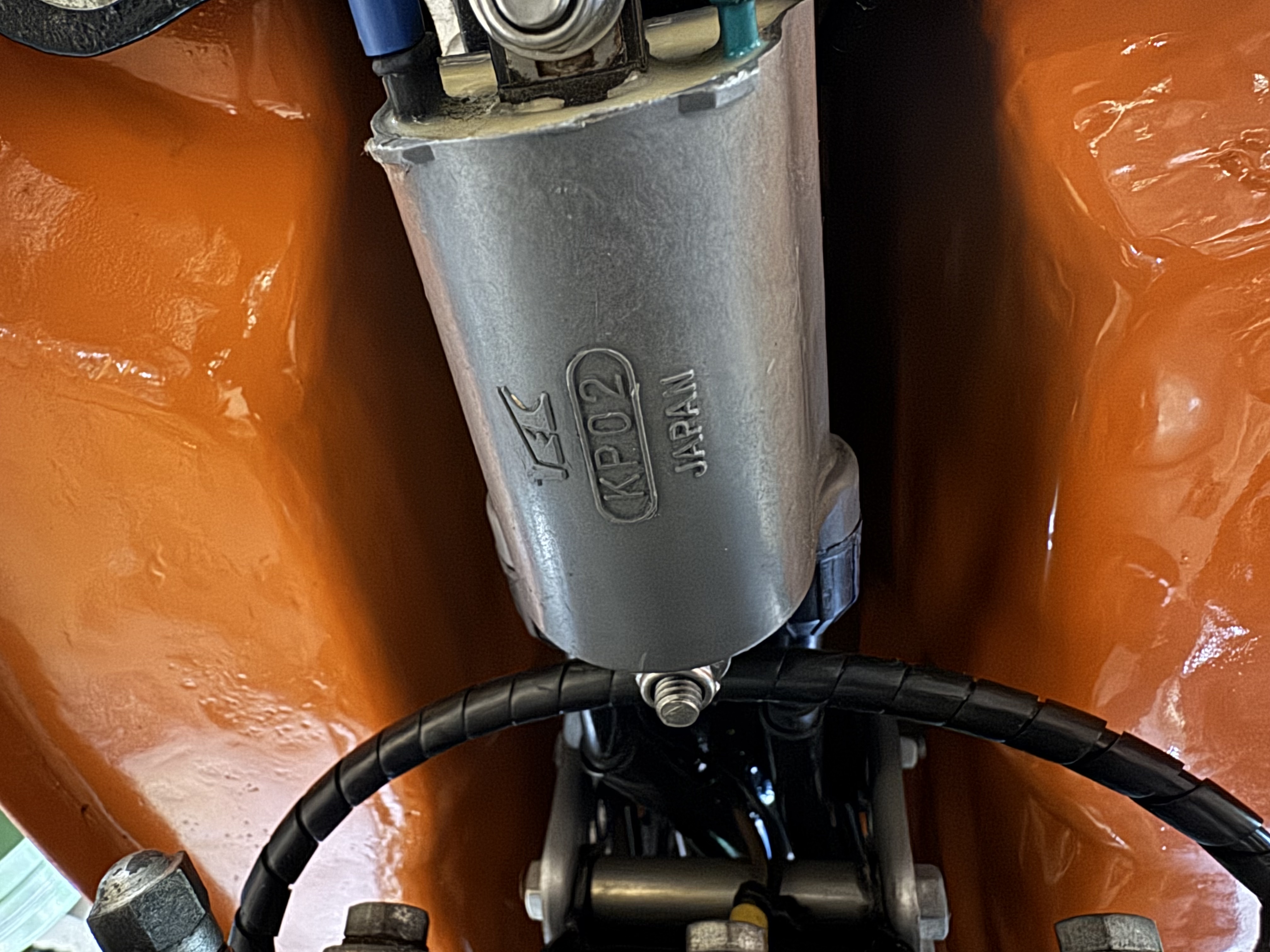

I only get a very weak spark with a Pazon EI (you need magnifying glasses to see it!). When the bike is running, it runs very well (although I'm only in a breaking in period and haven't exceeded 3800 rpm).
I have a Pazon Surefire (circa 2019) EI with Tec KP02 coil. I've tested the crank sensor with Pazon's test routine of directly connecting the black white, yellow white cables and get a weak spark. I've tested that I have full voltage from the ignition barrel to the control unit and that is fine too.
Any ideas? Should I just replace the coil? Its not a typical twin lucas system - I'll attach photo.
Would be nice to get a big strong spark the way it should. That way I can eliminate that from my worries when I'm kicking it over!
In addition to Gordon's…
In addition to Gordon's remarks, don't forget also that with a twin output single coil, you are effectively sharing the strength of one coil across two spark plug gaps.
By nature, this will also change the appearance to the naked eye - sometimes you may have to close down the gaps accordingly.
Ah Gordon! You may have…
Ah Gordon! You may have prevented me from setting a few expensive hares running! That would explain why it's running so well. Starting must be something else - its the old '90% of ignition problems are with the carburettor...'

I was fooled by thinking I had a weak spark also.
Fitted a new coil which made no difference.
Then I read the fault finding info:
Sparks from high power systems look different from old points based systems, they are very focused (hence appear "thin") and lighter blue (hence barely visible).
