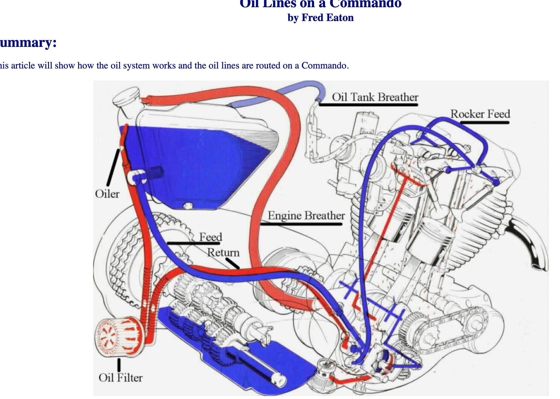

Beer can wins cheers Stan, I can't believe there isn't a separator system available (see attached) there's loads on line.
The one in the diagram is…
The one in the diagram is from a Mk2A / MK3, which Andover will sell you for about £22.
I'm not happy that the 'condensed' oil ends up in the inlet manifold; I'd rather it went back in the tank. But it is something you could readily fit to your bike and, together with the breather valve modifications you'll find on this forum, should allow you to route breather gasses into the air box and not fill it with oil.
