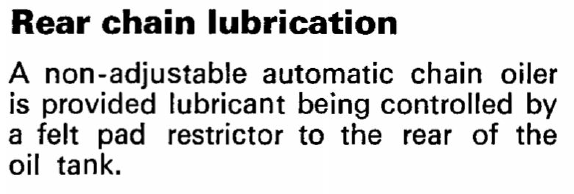

Rear chain lubrication is dealt with on page 19 of all three publications.
Working from last to first, the 850 Manual contains the text quoted by Gordon. Note that this does not illustrate the adjuster or specify its location.
The #220000-on manual has this:

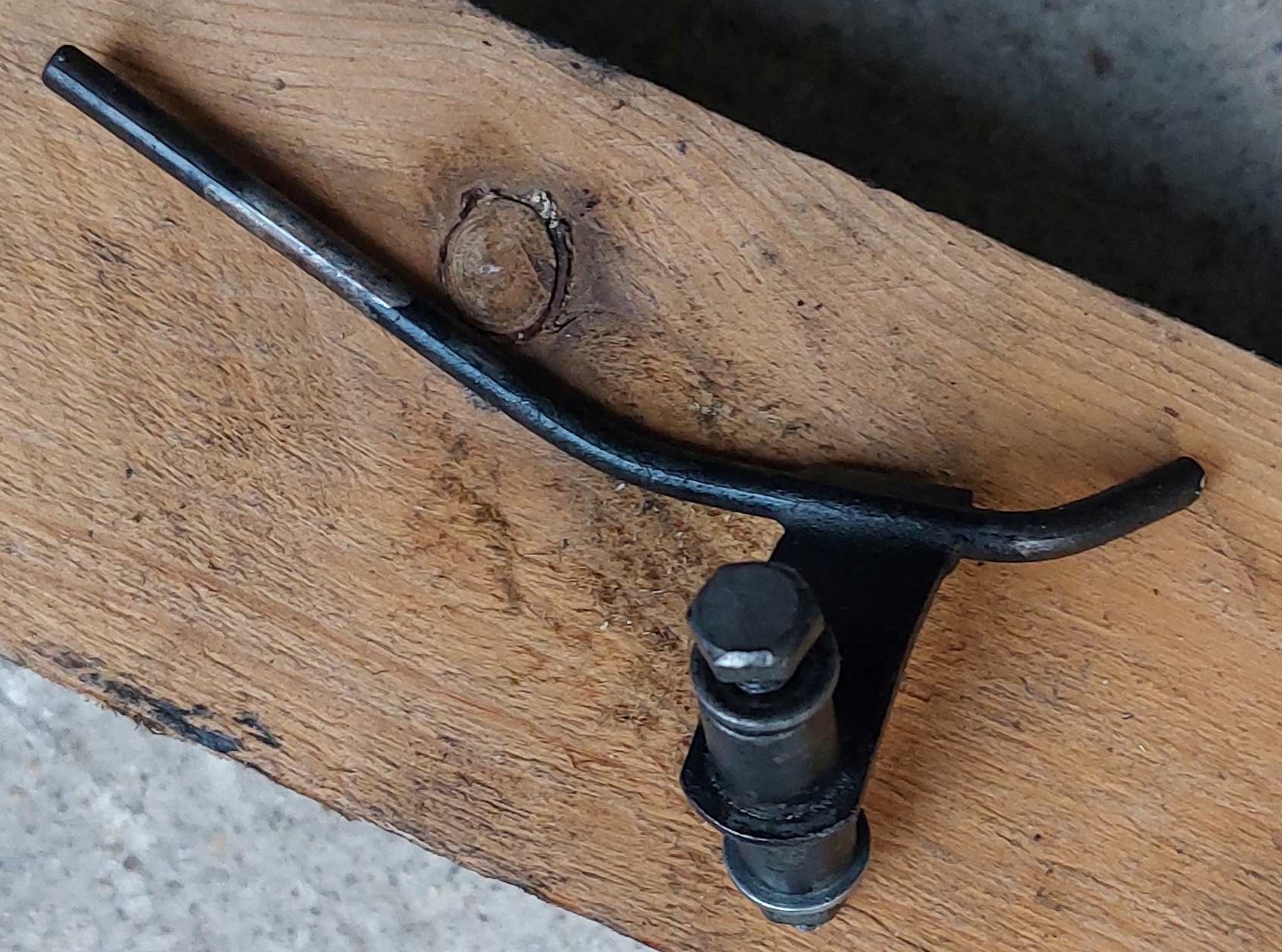

Now I know what this is for.
Thanks to the drawing linked above I now know what this thing is for. It fell out when I removed the chainguard today. I guess a previous owner removed all the connecting bits though.
The clip in Julians photo is…
The clip in Julians photo is a Unex clip, still available new. They are stainless with a brass screw.
Available in sizes from 7mm to 40 odd. The pressure rating of them is huge and due to the constricting action they due not 'bulge the pipe like jubilee clips tend to do.
I have to say that I think Gordon is wrong; neither of the Commandos I have owned have had anything resembling the fitting he describes.
Rather, the flow to the chain is "controlled" by the bit of felt (28) stuffed into the length of clear plastic tube (29).
