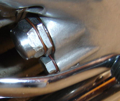

I have a Smiths oil pressure gauge to fit to my No. 7 tank, which has a factory prepared hole already in it, but I don't know where to connect the business end of the coiled copper piping connected to the gauge. Can anyone help and if possible with a photo please.

Hi William,
Remove the bolt below the oil pressure release valve (see attachment) and replace it with a suitable oil pipe union. The chamber behind the bolt leads directly to the pressure feed to the crankshaft

Hi William,
Remove the bolt below the oil pressure release valve (see attachment) and replace it with a suitable oil pipe union. The chamber behind the bolt leads directly to the pressure feed to the crankshaft,

Hi William,
Hi Robert
That's really helpful and thanks for the photo. I see exactly where to fit it and this will be my next rainy day job which with the summer we're having probably won't be far away.
