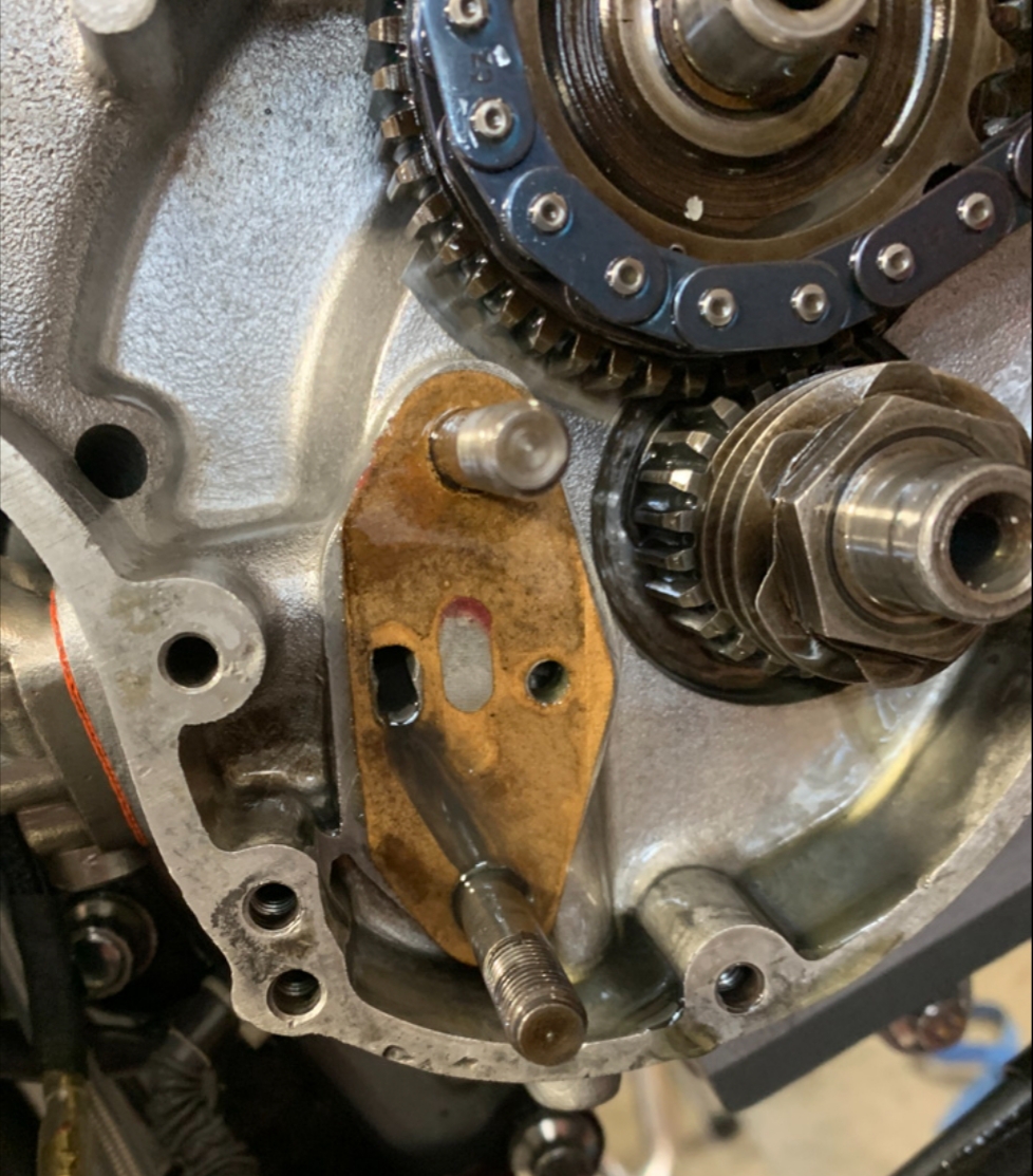

1)  Check that the oil feed and return lines have not been reversed.
2)  Some oil filters have a one-way valve inside. Reverse the feed and return by mistake and oil will flow from the tank into the engine but not return very easily.
3)  A blocked scavenge caused by a piece of tissue did the same to my 500 twin engine.
4)  Take off the Timing Cover and check the obvious. Is the oil pump worm turning when the crankshaft rotated.   has the Woodruff key been left out?  Has the oil pump rubber seal been left off.  Ditto for the Timing Cover seal.
5) While the Timing Cover is off turning the crankshaft should confirm that the oil pump is working when oil flows from the pump nipple.
Thanks guys for all the input I will have a good look Sunday if nothing seems wrong I will have to take it to bits again and check the modifications cheers mark.
I'm sure I read once that someone had the same problem which turned out to be the gasket on the back of the pump was on the wrong way and covered the scavenge side.
Who assembled the crankcases after the 'mod' was done? They could have blocked the scavenge side drilling will sealant.
Timing case and oil pump off and blow through the port, into the case with compressed air. This HAS to be clear
Did you have photos of the case when being modded? i.e. as a check that the mod was done correctly.

Well gentlemen after much fiddling I came to the bleak conclusion that was to strip it right down again and have a look myself as I didn’t assemble the crankcases the first time. When I did I found the work was all as should be the original hole was welded up and there was a suitable recess for the oil to escape back to the pump . There was a small amount of debris that I blew out . I thoroughly cleaned and reassembled the bike it now works fantastically well I have only done 50 miles on her as I finished the job Sunday but I am confident it is fixed thanks for all the posts all the best mark.
so was the debris the main cause?
