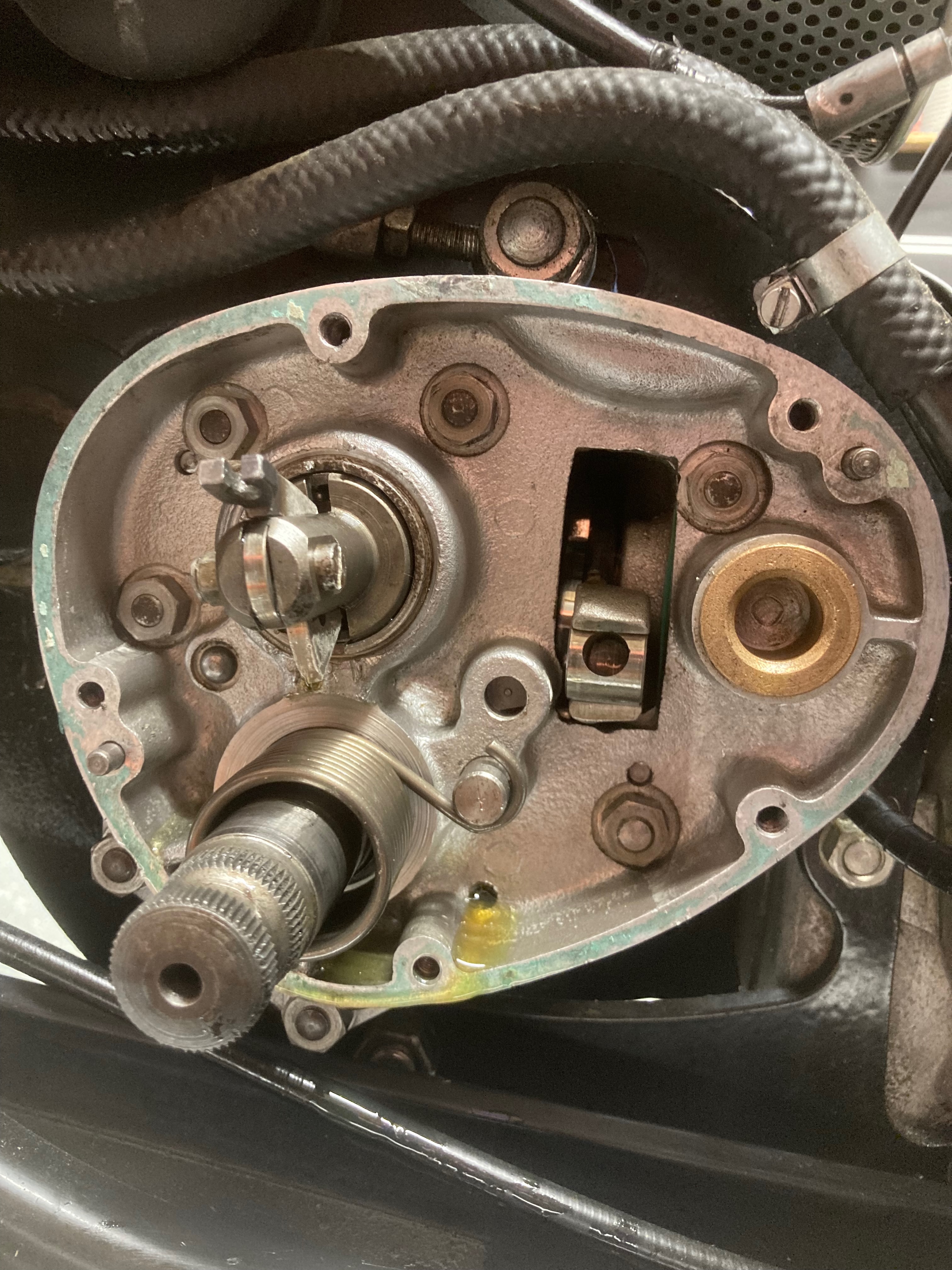

Having got her running thought I would see if she can move. Can't get into first gear. Goes into second no problem from neutral but not first. 3rd and 4th appear to be obtainable too but not actually ridden it down the road yet. It's as if first doesn't exist!. Getting back into neutral from second no problem. Before I start taking it apart any pointers? Ta.

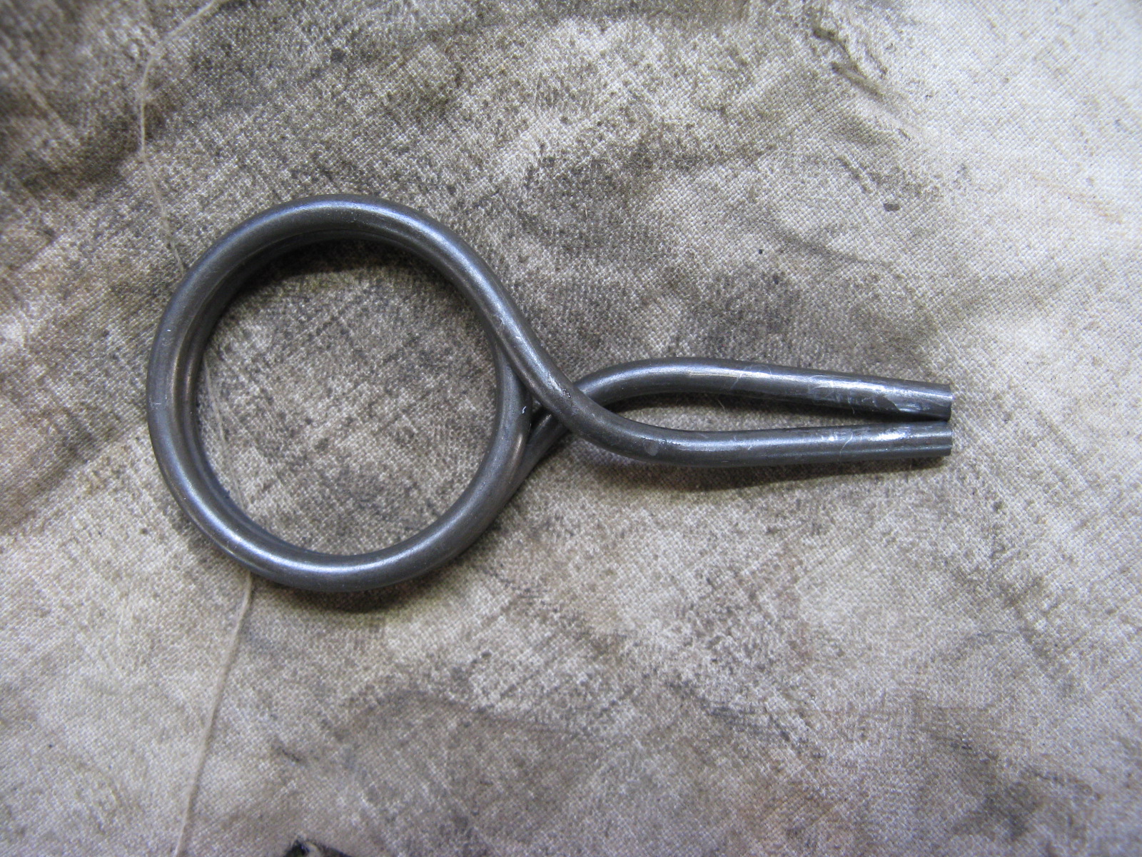

If the gears can be selected going up to fourth but not coming down then the problem could possibly be a broken return spring. This is the chunky spring that sits under the pawl spring mentioned above by Robert. Photo below.
Otherwise Dan's suggestion would be my next line of investigation..
The return spring as shown…
The return spring as shown in Phils reply can have a "dead stick" failure crack that it almost invisible untill its out for inspection.

Progress

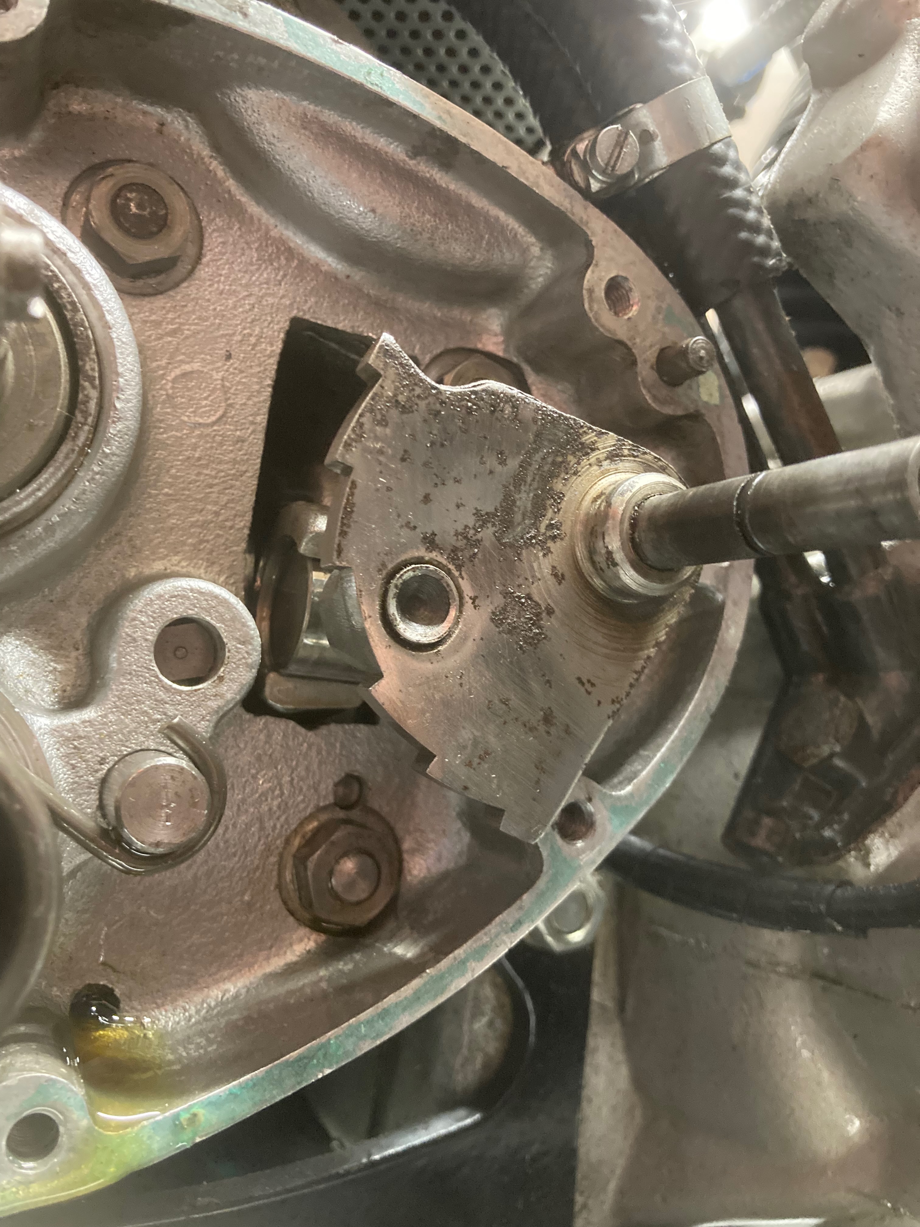

Have taken the outer cover off today. The bike is in neutral. The quadrant and its roller is at the bottom of the window. Would this explain why I can't select first as its got nowhere to go being at the bottom already? Thoughts? Mick Hemmings DVD will be ordered tonight. Ta

If the quadrant is at the bottom...
... it suggests the timing is out by 1 tooth. If you go through the box to top there is likely to be quite a big gap there. No real way of fixing it other than taking the inner cover off as far as I know.
