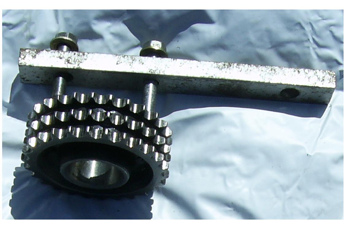

Make a tool.........the sprocket should have two holes for a puller.
nuts.
I used a short piece of steel bar, two long studs and 4 UNF nuts.
The picture below shows a simpler version that used two long bolts.
