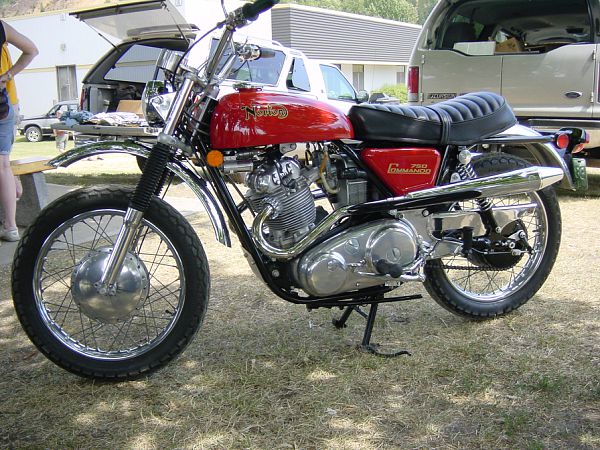

I agree with Richard regarding the 'Replica' shown in the Models listing.... However I came across the attached picture of an SS which I think is probably nearer the original? It's not clear if the base is steel orfibreglassthough!
Attachments norton-commando-ss.jpg- Log in to post comments
That's more like it! If I…
If I were ultra-picky, I might query the tank and side panel decals but, having mis-laid my anorak, I really couldn't say.
