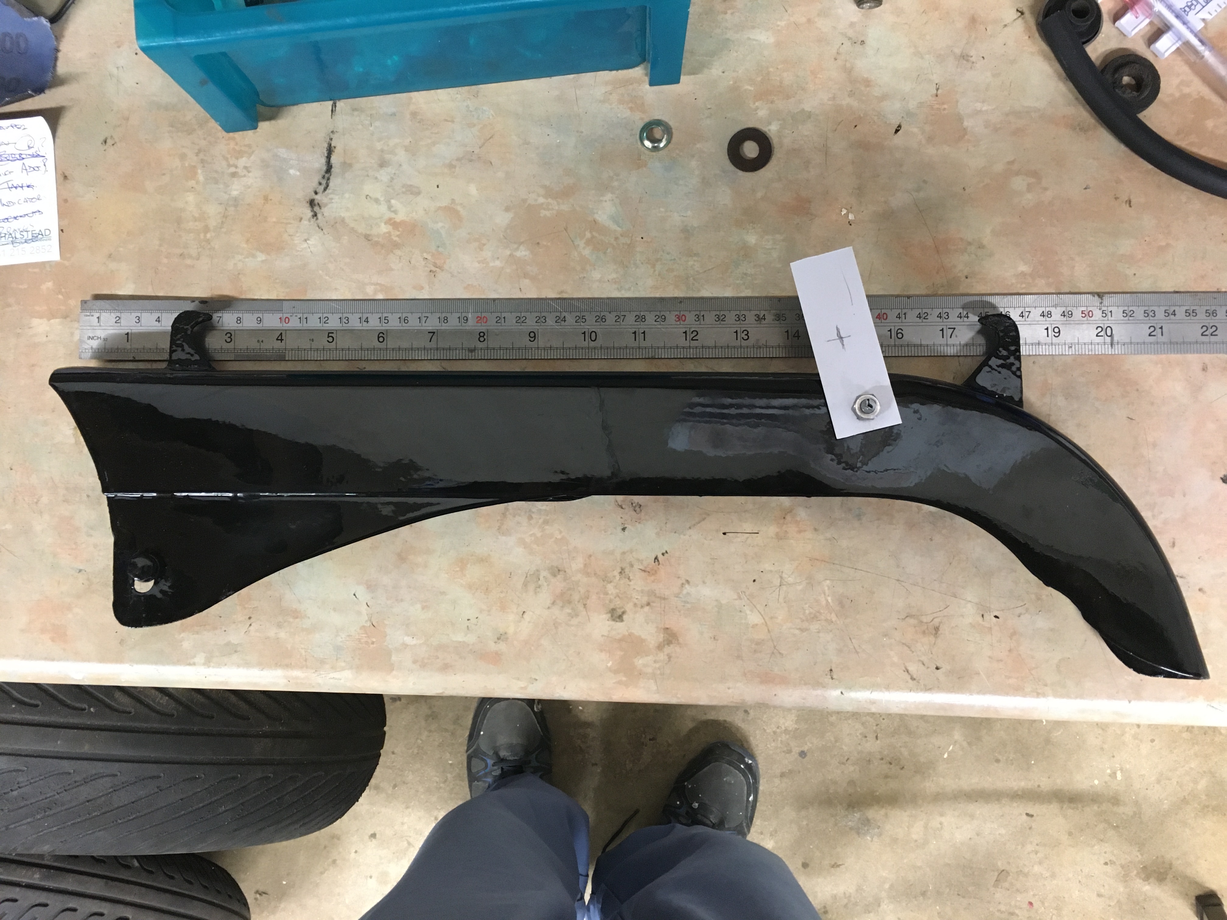

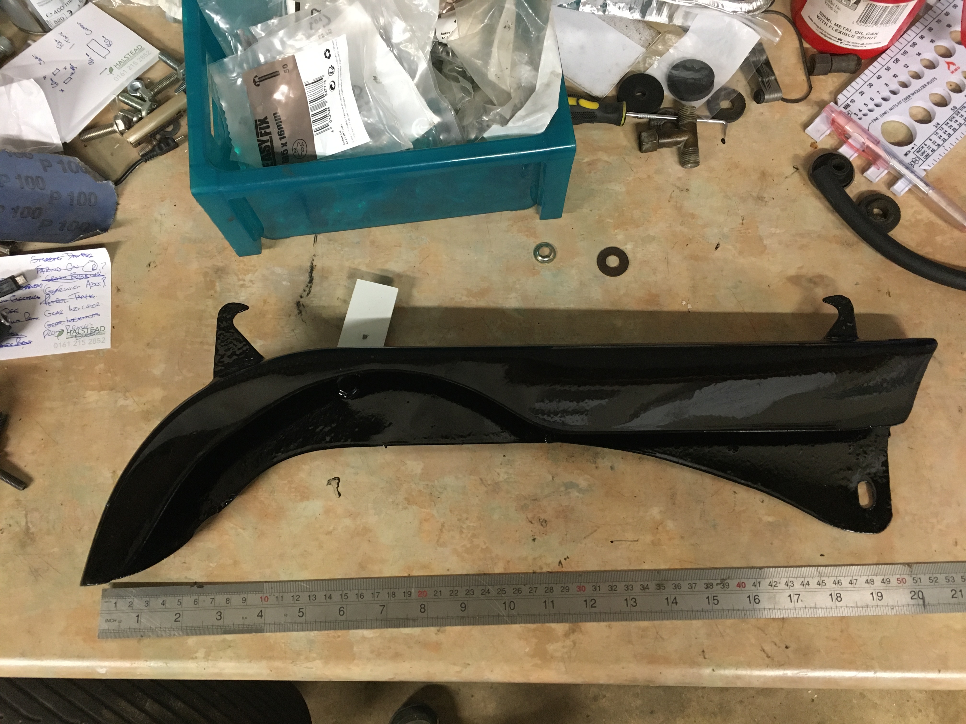

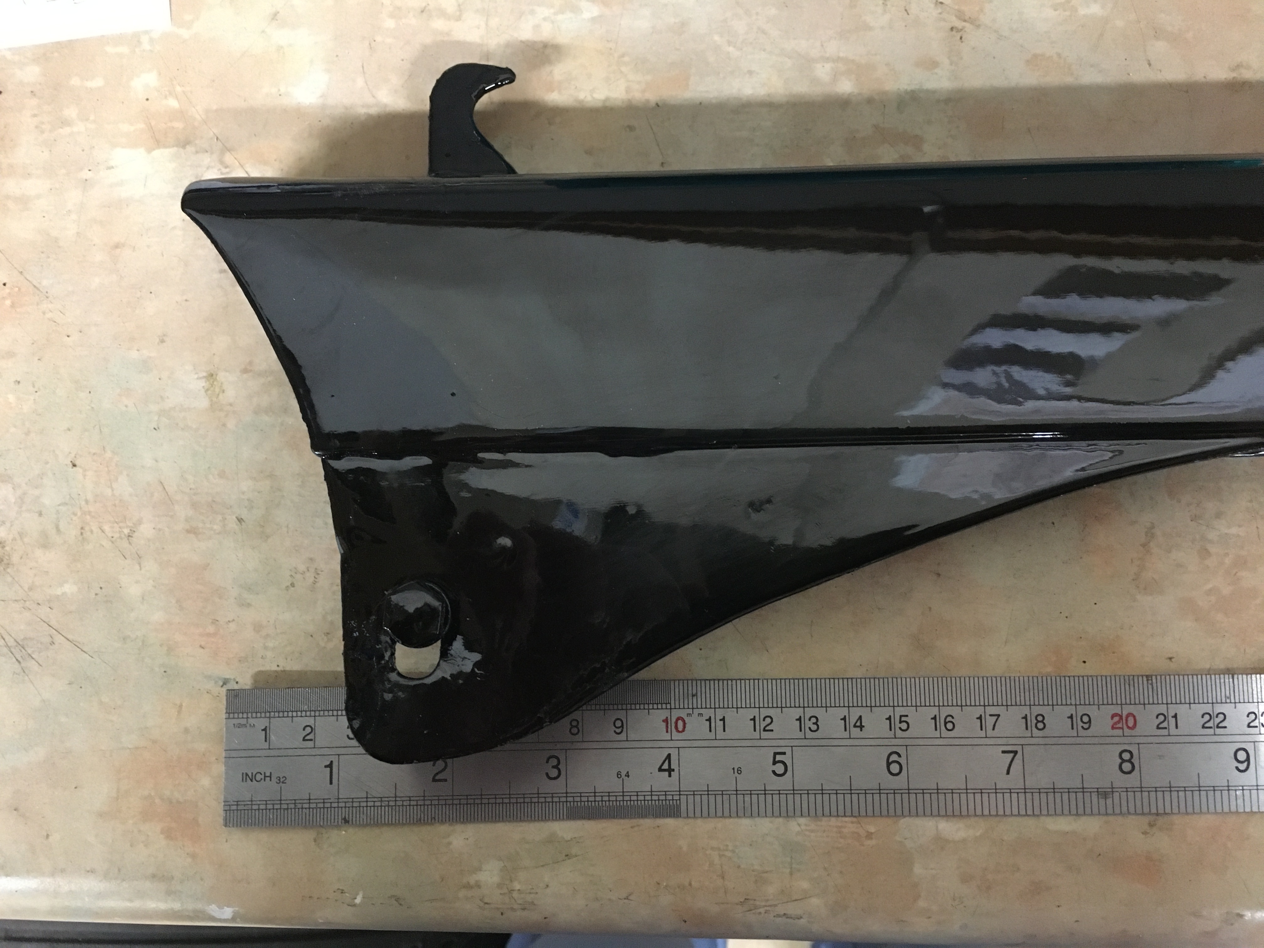

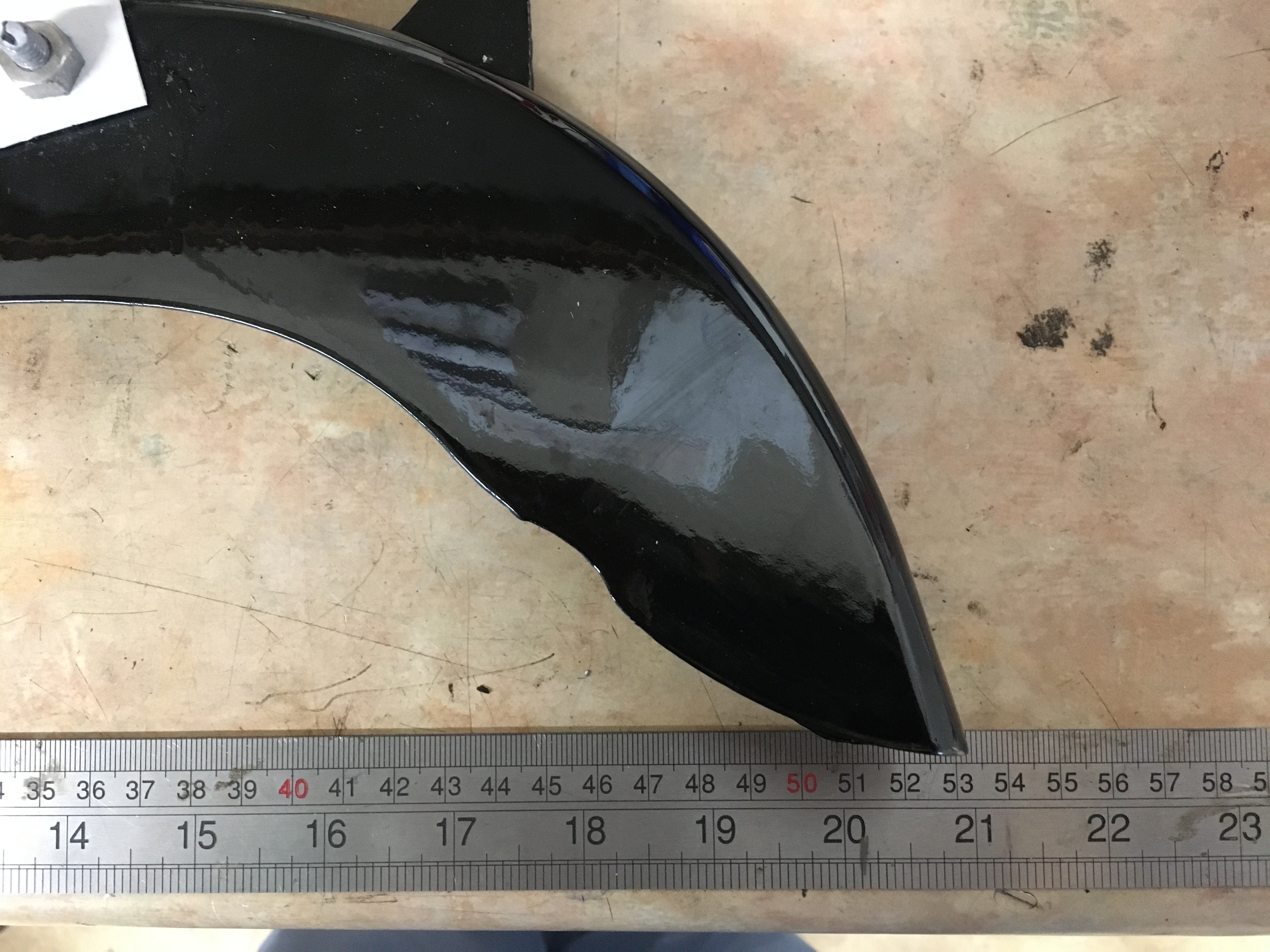

Hi Jon
Ive attached some photos of my chainguard.  It’s from a 1952 Model 7 plunger. Not sure if it’s what you’re after.
The white plastic is for a pattern to make a bracket to join to the rear spring pinch bolt
hope it helps

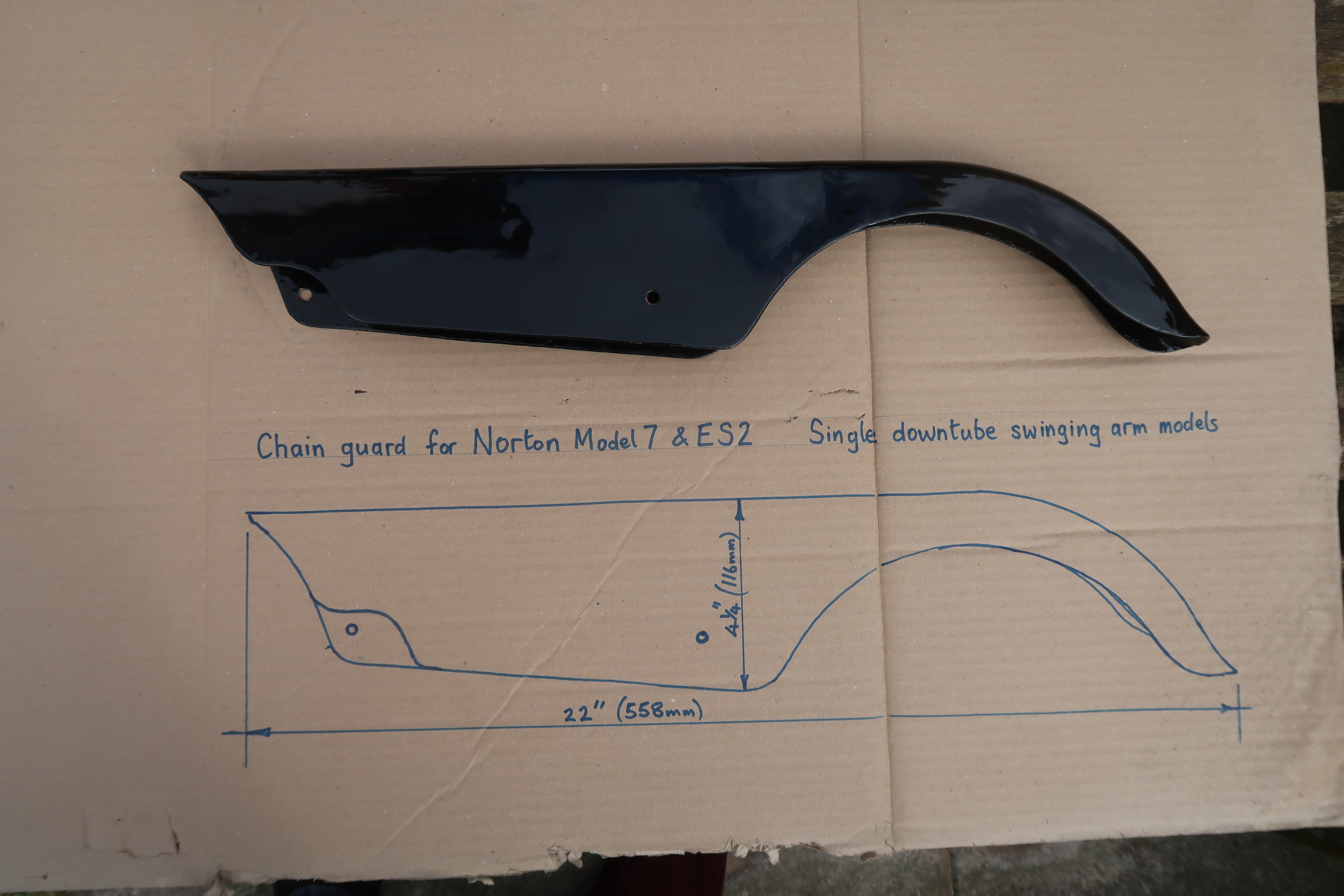

The Model 7 chain guard is the same as the ES2 for the single downtube swinging arm frames.  Doug's chain guard for the plunger frame is quite different and won't fit.
Later today I'll take a photo of one that I have for my Model 7 project and make a few measurements for you.  These chain guards were only used for 3 or 4 years so are quite difficult to find, but do occasionally turn up at autojumbles.
