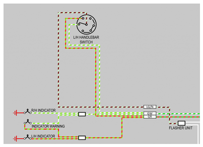

You have a couple of options…
You have a couple of options.
My preference is to use a modern flasher unit that has a separate line for the warning lamp.
The other benefit of a modern flasher unit is that you can use LEDs, incandescent lamps, or a mixture of both, as you no longer need to make up the magic 42 watts per side to get the flashing speed correct like you do with the original LU35048 flasher with it's bi-metallic strip.
I did an article about this sometime ago which you may find useful:

Bulb indicator warning ...
Thank you Tiller for your post.
I have always been wondering about how the indicator warning of my MKIII commando does work...
According to the standard electrical diagram (casual bulbs fitted, no LED),
when left or right front and rear indicators are activated, I am wondering about current indicator warning bulb return way to earth .
- Is the circuit closed by mean of the 2 opposite non operated bulbs (front and rear)?
- In such a situation how come they do not bright unless tungsten filaments are about 0 ohms resistors? They should ...
Another question if you don't mind.
Does a "LED warning light tweaker"
does correspond to the diagram modification you mention within your article ?
Looking forward to hear from you !
All the best. Jérôme

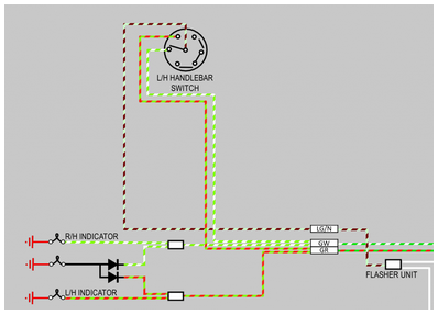

no problem!
Yes, some people call the diodes a "tweaker"
It is exactly what I show in my diagram.
If you go this route, make sure you order for the correct positive earth setup.
...otherwise you will have to cut through the heatshrink sleeving and resolder the diodes.

The original idea...
The original idea for the indicators using 2X21 Watt lamps each side is that the warning bulb being only 2W (low current) gets its earth return via the low resistance (when cold) of the twoX21W lamps on the other side.
Hence when you go to LED this sytem does not work. So we have a 'normal' circuit to earth with a new LED warning lamp, but it needs a diode feed (tweeker) from each side of the indicators to make it work.

Thank you Alan for your post.
When you say "but it needs a diode feed (tweeker) from each side of the indicators to make it work.".
Does it correspond to Grant Tiller electical scheme (down below) were 2 casual diodes are represented ?
Does the "dark dual diodes add-on" on scheme correspond to the wired item photo ?
Would you know which type of diode to be used; "1NA ..." ?
Regards.
Jérôme

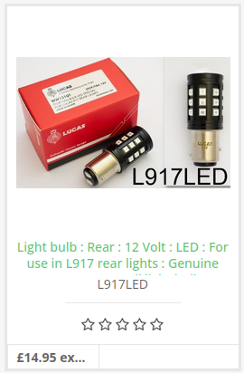

L917LED
Hello,
Another question concerning LED conversion on my 1977 MKIII Commando.
I just bought from the NOCSHOP a LUCAS LED light bulb "L917LED" intended for the tail light (Rear 917 LUCAS)
I am very much surprised and disappointed whereas it does not work as it should (I already converted the original liquid acid battery by a gel acid battery to improve the electric start - I am not far to my 70's ...).
In fact when braking, light emission is maximum (front or rear or both selected), but I turn on lights (pilot / head), again light emission is also maximum. Therefore it is no braking warning from rear ...
How come ? We all know Commandos are positive hearth.
- Should the L917LED device be a negative hearth ? (but it should not work ...).
- Or is it a question of power; too strong current, need of some ballast in tail stop loom?
Thank you gentlemen for any advice.
Looking forward to hear from you.
Jérôme

Hi Jerome, You may have seen…
Hi Jerome,
You may have seen:-
Due to the unusual configuration of the L917 rear lamp bulb holder, which points down towards the number plate clear lens, Lucas have developed a special LED bulb just for this application.
White LED chips face the number plate clear lens whilst red LED chips illuminate the rear lens, with the red light intensifying when the brake is operated.
This is a simple fit and forget bulb solution requiring no expensive LED boards or soldering to upgrade your L917 rear lamp.
PLEASE NOTE: Make sure the earth connector has good continuity back to the battery. This is critical for the bulb to function correctly.
So, take the lens cover off and look at the bulb. With lights off, press the brakes and the red LED's illuminate.
Turn the lights on and the red LED's should come on plus the white ones.
Now press the brakes, the red LED's should now get brighter.
Note the Please Note, if the earth is dodgy, it could easily give the symptoms you are seeing.

Hi Al, However, the L917…
Hi Al,
However, the L917 bulb is:-
Dual polarity so can be used with both positive and negative ground systems.
Jerome - Please look at my reply to you just above this one. not obvious with the way the system orders responses.
Correct...
Some LED can be configured to be Positive or Negative Earth, but not by Lucas as the Lucas company finished in the 1980s. The items you buy in a Lucas box these days are made in the far east under the Wassel name, mostly these products work ok.
The bulb being discussed…
The bulb being discussed here is specific to the Lucas 917 lamp unit 'cos it has both white and red components.
Even so, it's difficult to see how an LED replacement for a 380 bulb can be compatible with both negative & positive earth wiring - I suppose you could split the 12V in half (6-0-6) and route accordingly with some clever internal circuitry, which might justify the price.
This lot https://www.feked.com/lucas-12v-led-stop-tail-lamp-bulb-917-type-rear-light.html say it's negative earth only. And that looks like the one in the NOC shop. Unless anyone knows better, I'd say this LED bulb is not suitable for positive earth electrics.
And, as a personal note, I can't see much advantage in reducing the power consumption of the tail light from 5W to 1.8W, saving a whole 3W. Might last longer but you can buy 8 x 380 bulbs for one of these LEDs.
Here is the note for WW13101…
Here is the note for WW13101 straight off the Lucas/Wassell website:
Lucas LED Stop/Tail Bulb.
12V, specially designed for the Lucas L917 Rear Lamps.
Can only be used on both Positive and Negative ground systems.
Power consumption: Rear lamp - 1.8W,Brake light intensity - 620 lm.
Please note :- Due to the unusual configuration of the Lucas L917 rear lamp bulb holder which points down towards the number plate clear lens, Lucas have developed a special LED bulb just for this application.
Important :- Please make sure the earth connector has good continuity back to the battery.
This is critical for the bulb to function correctly!
...it seems to contradict what the boys at Feked are saying.

Hi Stan, Re your comment:-…
Hi Stan,
Re your comment:-
All you need inside the bulb itself is a simple bridge rectifier, so just 4 more diodes, pennies.
Then they do not need to make two versions of the same bulb.
Thank you gentlemen for your…
Thank you gentlemen for your involvement concerning how a simple 5' operation turns to a burden.
To summarise your comments and recommendations, whereas my bike stands in a fairly well condition, I come to the conclusion that I must begin to check health of the electrical loom at first, avoiding a waste of speculations. This is often where the problem remains.
But this exchange has the advantage to highlight details that escaped me despite their obviousness.
About negative & positive earth wiring, it is obvious that concern is under control of a casual 4 diodes bridge (same as for AC to DC conversion) when power is not a major constraint. I should have thought of that. Thank you Tony Ripley mentioning ...
About the controversial of FEKED announcement I keep surprised it says about Tail Lamp Bulb - 917 Type Rear Light it's negative earth only. How come they mention "Lucas 917 rear lamps were fitted as standard to T140, TR7, T150, T160 and Norton Commando models"; and then "Please note: Only suitable for negative ground applications" since these period models were all positive ground ? We all know that. An I.A. transliteration mistake ? ...
To answer Julian Wells about my concern with this unlikely "L917LED" light bulb:
- With ignition (only) on, the red light intensifies (maximum of light) when the brake are operated (front or rear or both).
- With ignition switched to lighting position, the red light still intensifies even though the brakes are operated or not (front or rear or both). Meaning it is only a maximum of light at rear lens when brakes are not operated ...
Therefore and according to what Tony Ripley says : "take the lens cover off and look at the bulb.
- With lights off, press the brakes and the red LED's illuminate.
- Turn the lights on and the red LED's should come on plus the white ones.
- Now press the brakes, the red LED's should now get brighter.
Please Note, if the earth is dodgy, it could easily give the symptoms you are seeing."
Dodgy ! ... It seems that this remark could be the keystone of my problem with this "L917LED" light bulb.
Thank you again gentlemen for your advice.
Jérôme (the froggy !)
