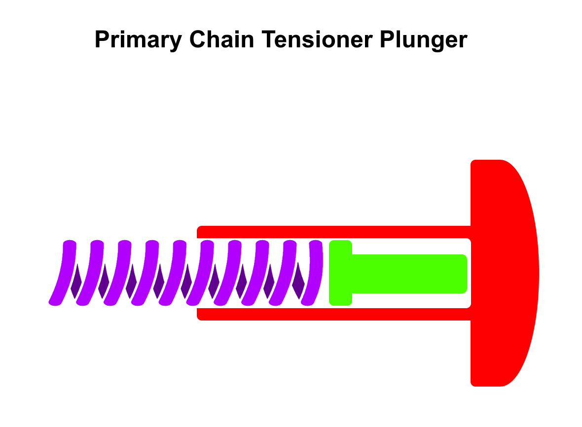

So which is the right way…
So which is the right way round? Seems to me you put the smaller diameter up inside the spring, i.e. opposite to the colourful diagram. Otherwise, why not have the same diameter over the full length?
Doesn't look like an overly complicated bit of plastic to me. Would acetyl (Delrin) do just as well?
Yes, it’s just a piece of…
Yes, it’s just a piece of Nylon - nothing extravagant or complicated.
It does seem strange that…
It does seem strange that someone designs a 'spacer' that has exactly the right size stub to fit inside the spring and then fits it the other way round.
I agree with Grant that this is what the book says, but why not use a simple bit of plastic the correct length?
Maybe it was designed to go the other way round but found they needed more preload. It is then a documentation change to swap it round rather than a new drawing, new part number and new instructions.

because...
@tony
To my knowledge, the shape is simply so that you stand a chance of getting it out again to replace it!
As it is, many of them get wedged in, and are a bugger to remove. My guess is there was swarf and burrs at the bottom of the hole when they were made originally.
On the rotary, they used the same assembly (Andover kit is the same part number), however they went to a metal dowel on the top one instead to get the spring pressure right. Confusingly, on the Rotary the same plastic spacer is fitted the other way at the top.
This way because they found the plastic wore away too quick on the top tensioner (where the spring does the damping in the main part without the aid of hydraulic action)

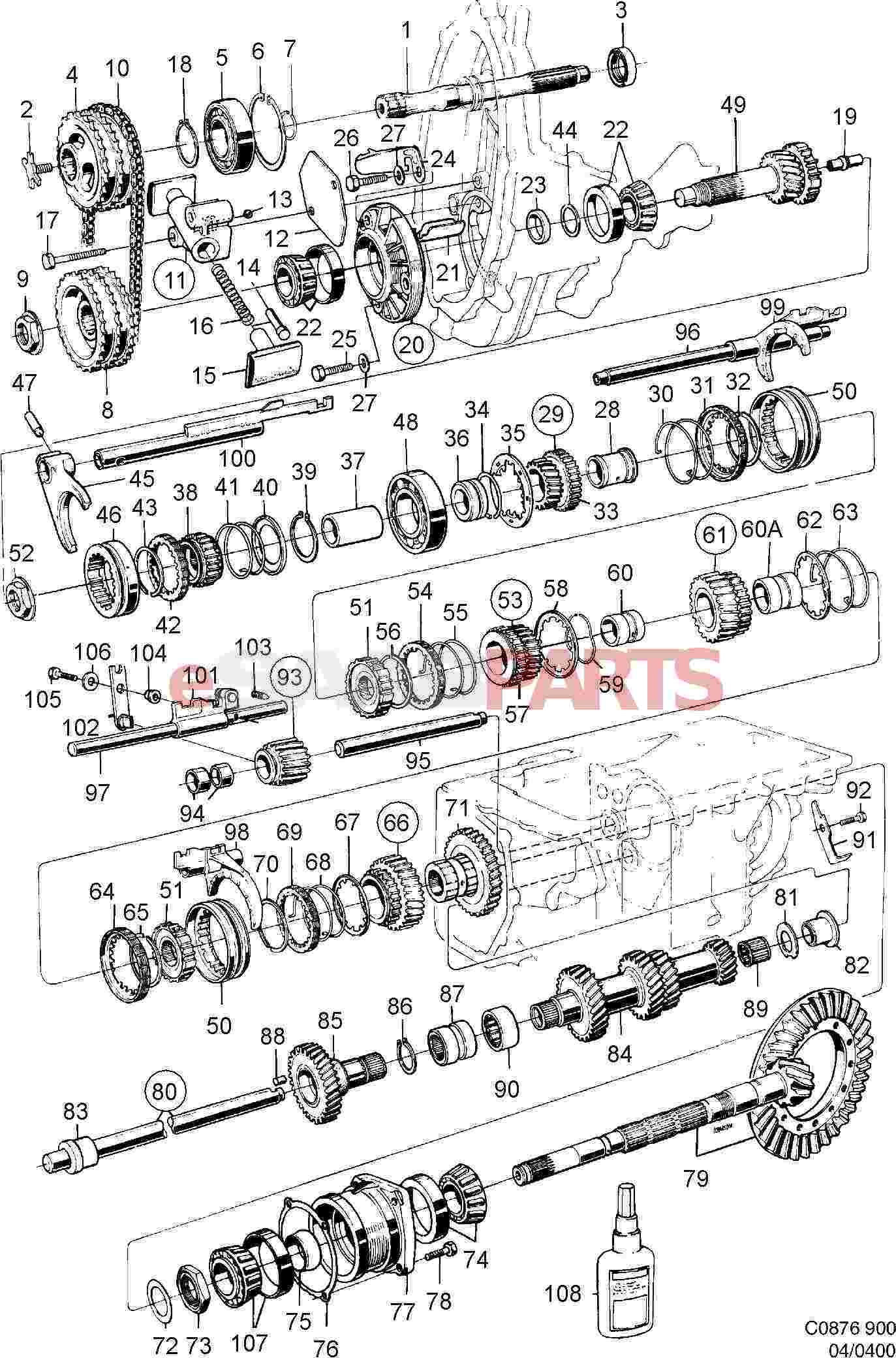

Any Saab buffs out there? …
Early eighties, a paper was prepared on joint efforts by Renold and Saab Scania in developing a transfer drive system with a chain between motor and gearbox.
Some Saab models actually have this system fitted which incorporates a double acting hydraulic chain tensioner sort of similar to the one in the Mk3.
The paper has a picture of the tensioner, it has the same British patent nr. 861741 number on it as the Mk3 plungers have.
According to the paper, there is only one stop, with the thin end going in first.
On later 900 models, another version of the tensioner, with coaxial plungers, and also one stop.
According to the parts drawing, here the thick end goes in first.
The drive ratio on these models can be altered by changing gears, resulting in more or less "play" of the chain.
Whether that has someting to do with the nylon stop..? Who knows?

The correct way to fit (as per Norton’s original design) is as per my drawing below. This is how every MK3 went out. Unfortunately, when owners dismantle and rebuild them, it is assumed they were assembled wrongly. When the plastic spacer is put in the wrong way, the chain is not tensioned enough and will slap (and damage) the primary case.
