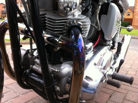

Added a few pics, one abov…
Added a few pics, one above shows oil on the Isolastics, rocker cover looks clean, this pic shows clean oil beside the tacho drive.
Jake.
Jake, Just a thought, if o…
Jake,
Just a thought, if oil is on the iso casing at the front thats a long way down from the rocker covers ! There would be oil all over the place. Is it possible that some is coming from the cylinder base joint ?
If you must check the rocker covers, first check that they are perfectly flat, rub round and round on a ceramic tile or glass with grinding compound. Then , using a drill bit by hand, countersink the underside of the stud holes in the covers. 8mm drill would suffice. this will ensure that they sit flat on the head. Try them without gasket first.
looks a nice bike otherwise!!
Regards HT
Does look like base gasket…
Does look like base gasket. Did you rebuild or someone else? Base needs some kind of gasket goo (Hylomar or very thin smear of silicone). I know people do use the base gasket dry but it doesn't hurt to have extra security here just as long as you don't overdo the sealant application. Alternatively the case halves may be leaking, they also need a little sealant help.

Thanks Hans will give it a go.
Jake
Update on work done: A ver…
A very big thank you to a Member of the Edinburgh branch ( I will mention your name if you want John) who has taken the time to show me how to remove the head (All bolts were loose) Head face was very porous, hairline crack between fins 3 and 4 front RH side! Basic check to see if the crack was the cause of the leak - unsure - (Thinking loose bolts at this time), fitted a new gasket and put it all back together again. Started her back up, lo and behold head still leaking.
