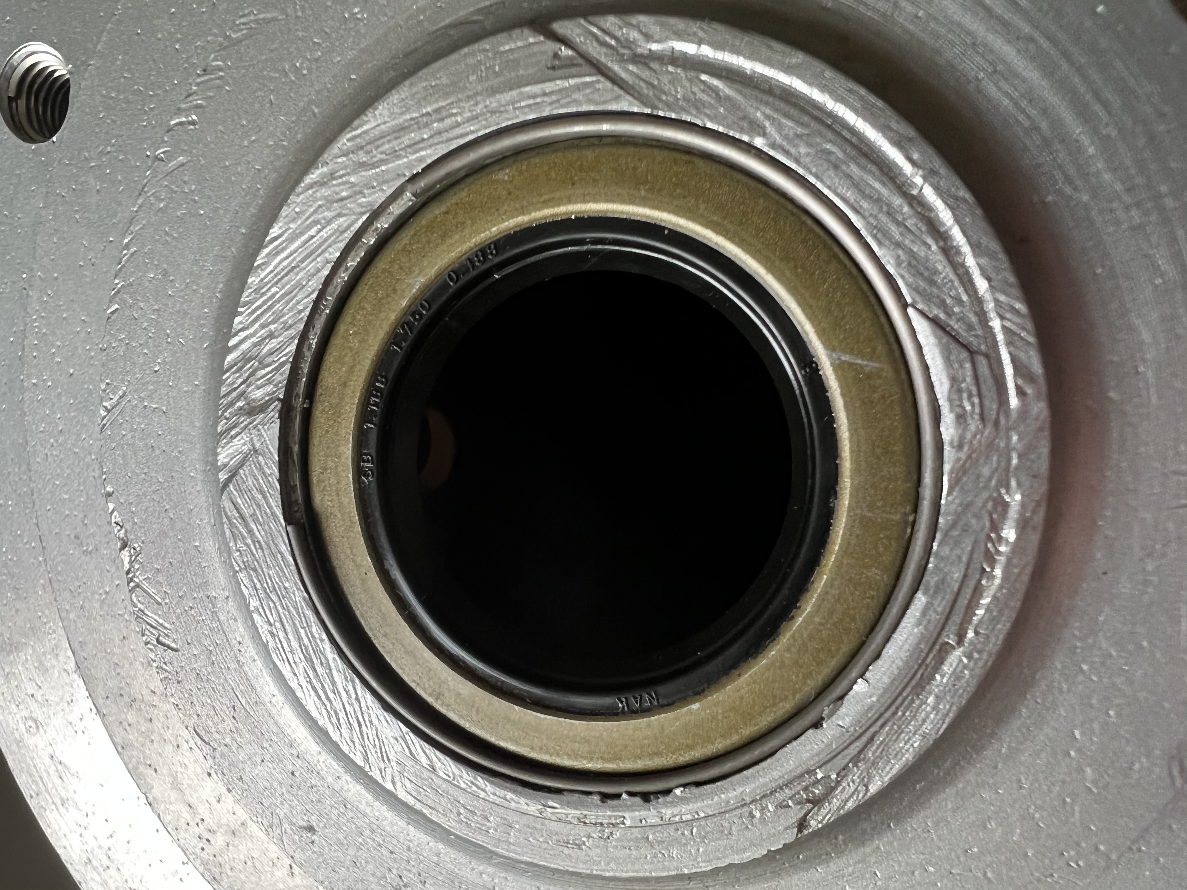

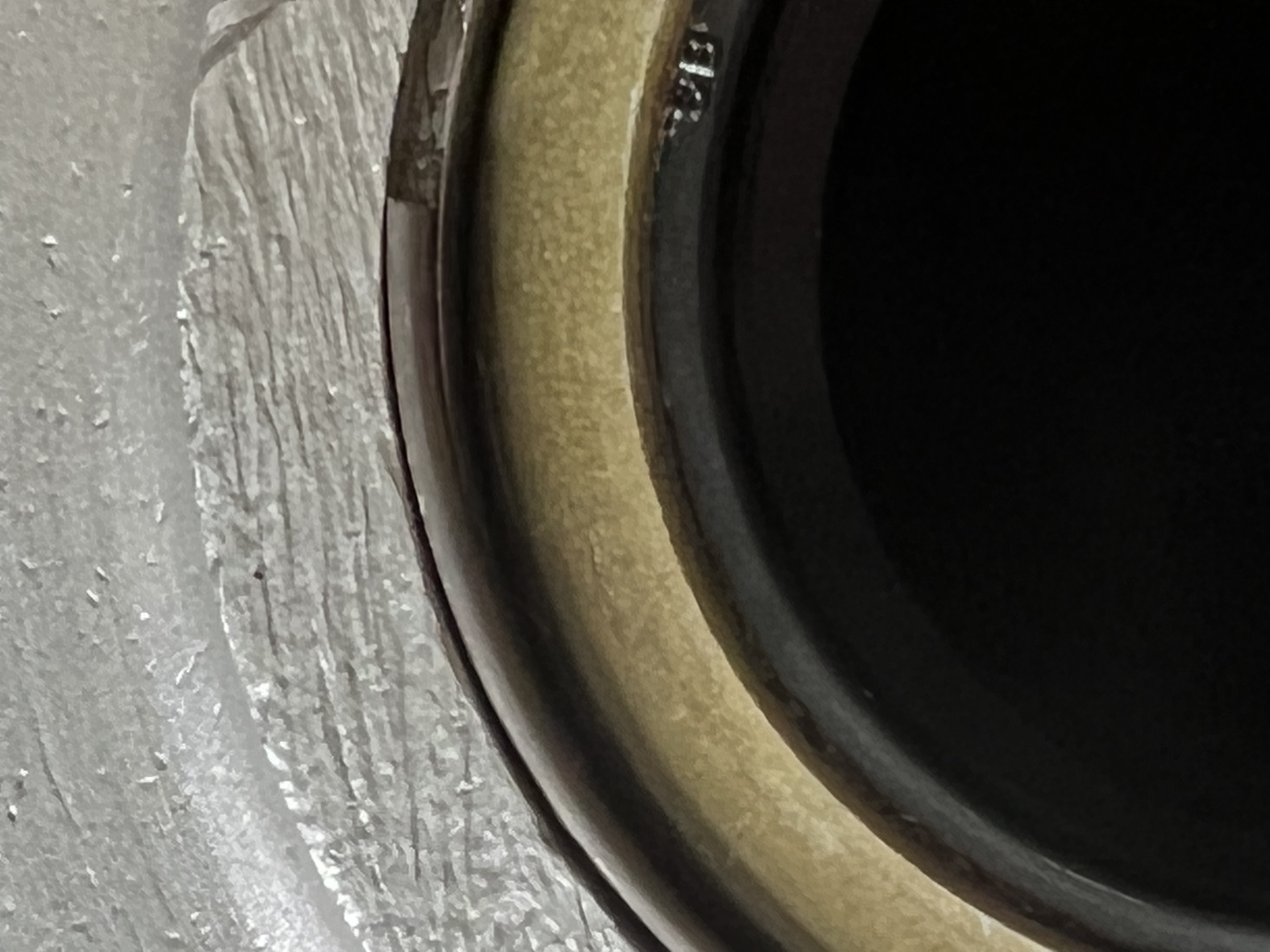

I have just started assembling my Mk3 crankcases and when fitting a new crank primary drive seal, found that the wire circlip groove is not great. The photos show obvious damage on the outer face that was present when I first stripped the engine, but the circlip was seated at that stage and needed prising out as normal, so the damage did not seem to be an issue - despite looking rough.  The cases went to Norman White for a timing side camshaft bush repair and vapour blasting, but apart from removing the main bearings prior to blasting, the drive side was not disturbed.
You can see that the new circlip hardly seats in some places and I do not trust it to remain in position.  So what to do?  Anything like epoxy adhesive just seems a bodge. A very steady hand with a small Dremel burr to increase the groove depth is the only thing an can think of, but that could go horribly wrong!

What the hell has ground that outer face away ? Norton introduced quite a number of new problems with the Mk3 which were never addressed as there was effectively no development once the model was in production. However, there is a fair amount of metal missing from the outside of the bearing / oil seal housing in this case.
Earlier models had a lip behind the oil seal which meant that the seal could at least be pushed in square. With the Mk3, it seems to be a case of enter the seal, then the circlip and gently ease the clip in, until it springs...hoping that the seal will still be square behind it. I prefer the steel-outer seals with a wipe of Loctite.

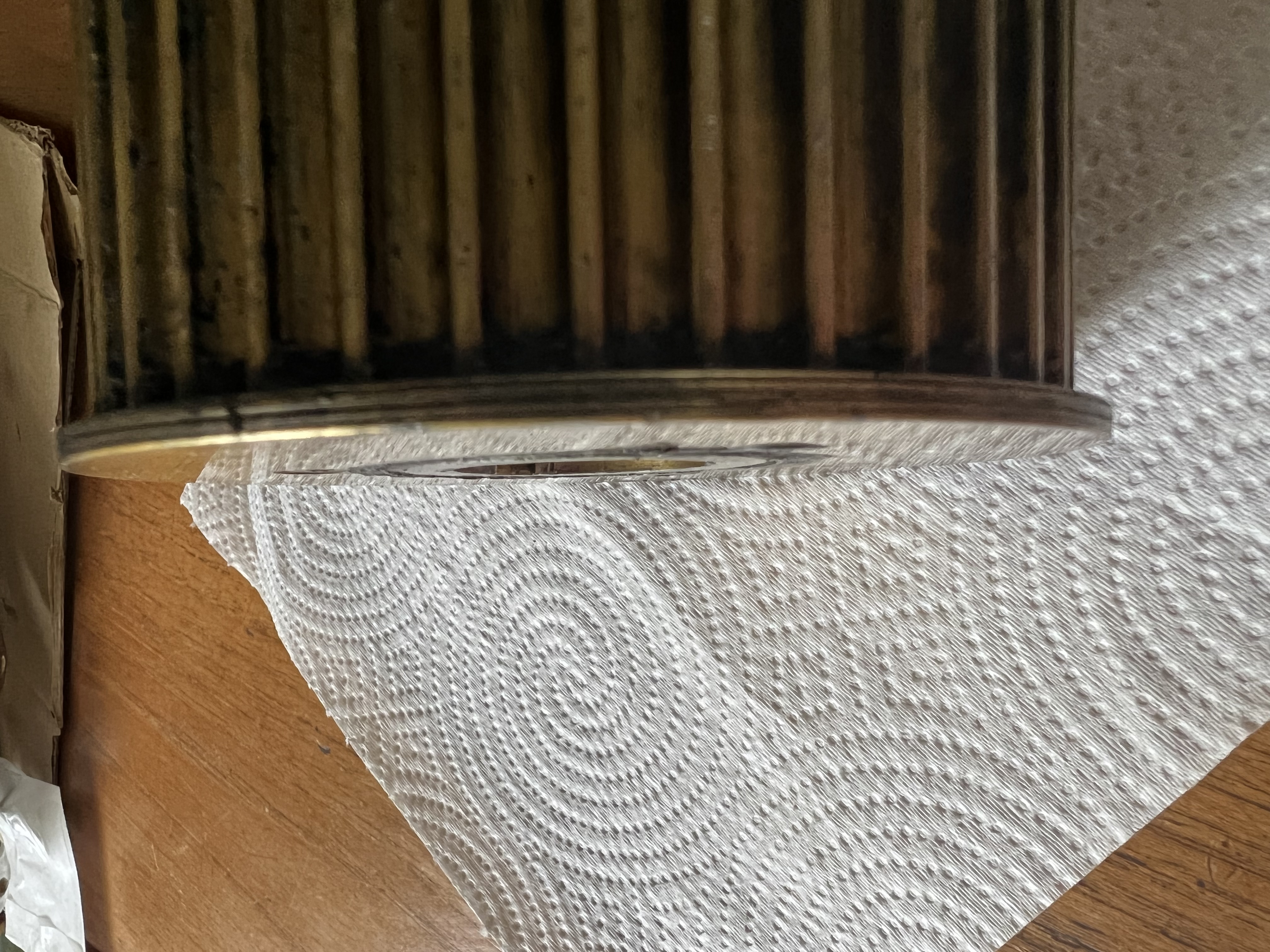

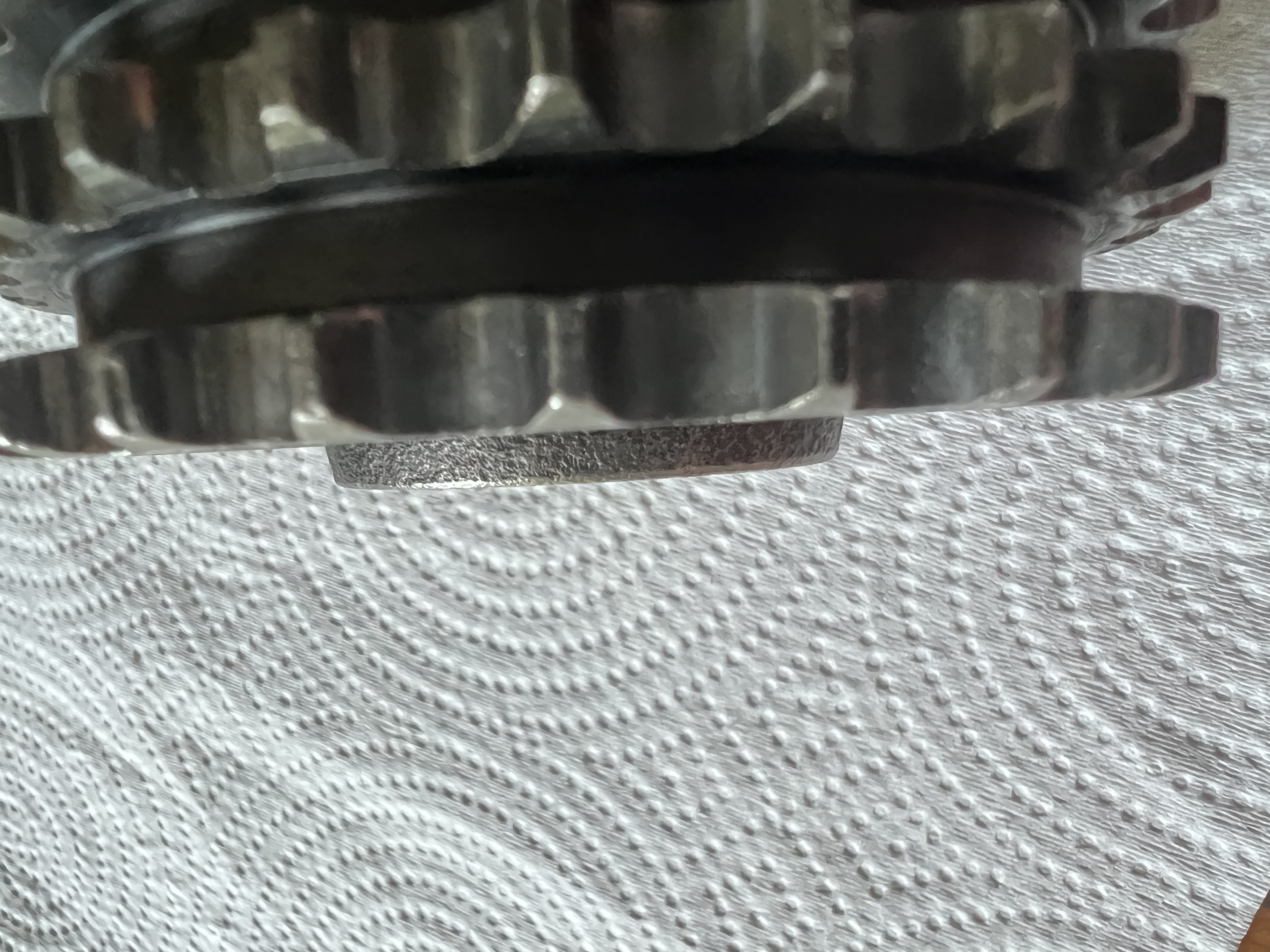

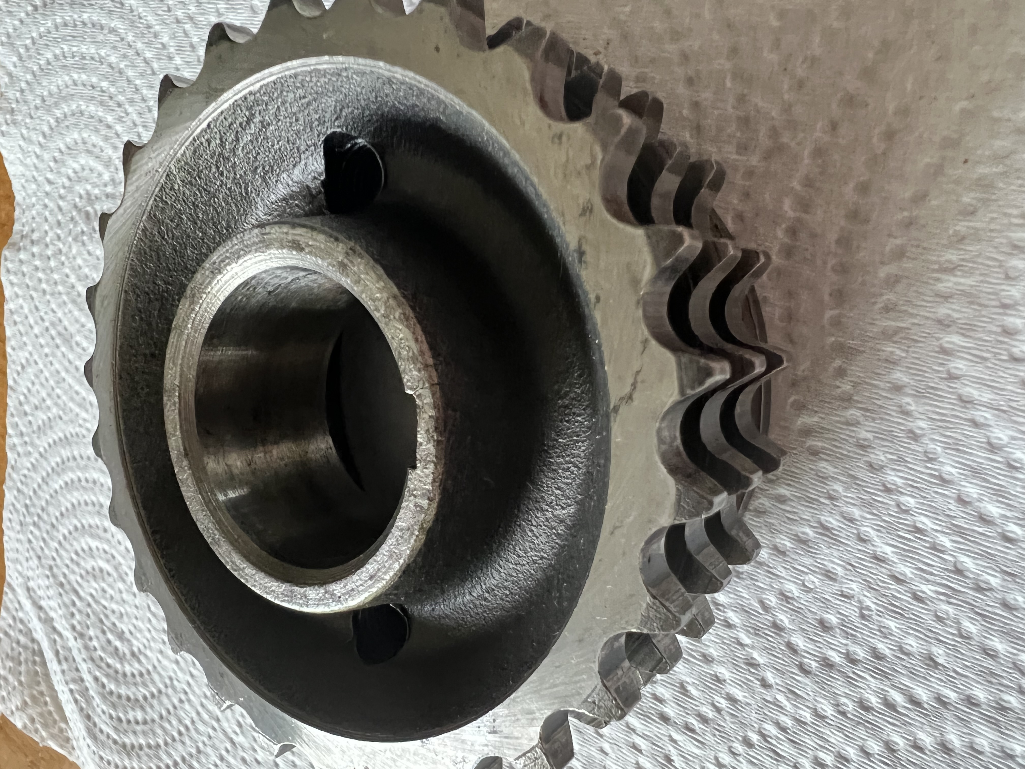

Not yet settled on a solution to secure the circlip, but have found what drove the butchery.  As mentioned, the bike (a non-runner wreck when I got it) had a belt drive.  Having compared the belt drive pulley to the proper chain sprocket, it is quite obvious that the crude pulley design (which looks awful) did not provide the necessary clearance with the casing. The inner face and taper boss are parallel, whereas the sprocket boss is proud of the inner face, the sprocket is also recessed, so there is no chance of casing contact.  See attached photos.  Is this a typical belt drive pulley design?
Quite why is was felt necessary to cause so much damage just to fit a belt drive to a Mk3 is a mystery? Irreversible damage was caused to the primary case and isolastic cradle; plus, the gearbox inner and outer covers were of course replaced with (poor condition) right hand change items.  Rectifying all that by finding replacement parts has proved time-consuming and costly, though I have been fortunate to be able to obtain new original items of almost of those.

That's not a commercially-produced Commando front pulley...something taken from an industrial belt supplier's stock I think. The previous owner was probably so proud of himself for having saved £50 on the conversion.
Mk3s can be fitted with belts without that butchery but there are limitations on pulley sizes.
Looks more like the results of a shredded belt to me (been there, back on chain now). The reinforcing cable inside the belts gets wound around the crank, tightens up and is forced outwards into the adjacent components. You could have it built back up with weld and machined back to standard dimensions.

Belt pulley looks similar to stuff that was available in the '80s.

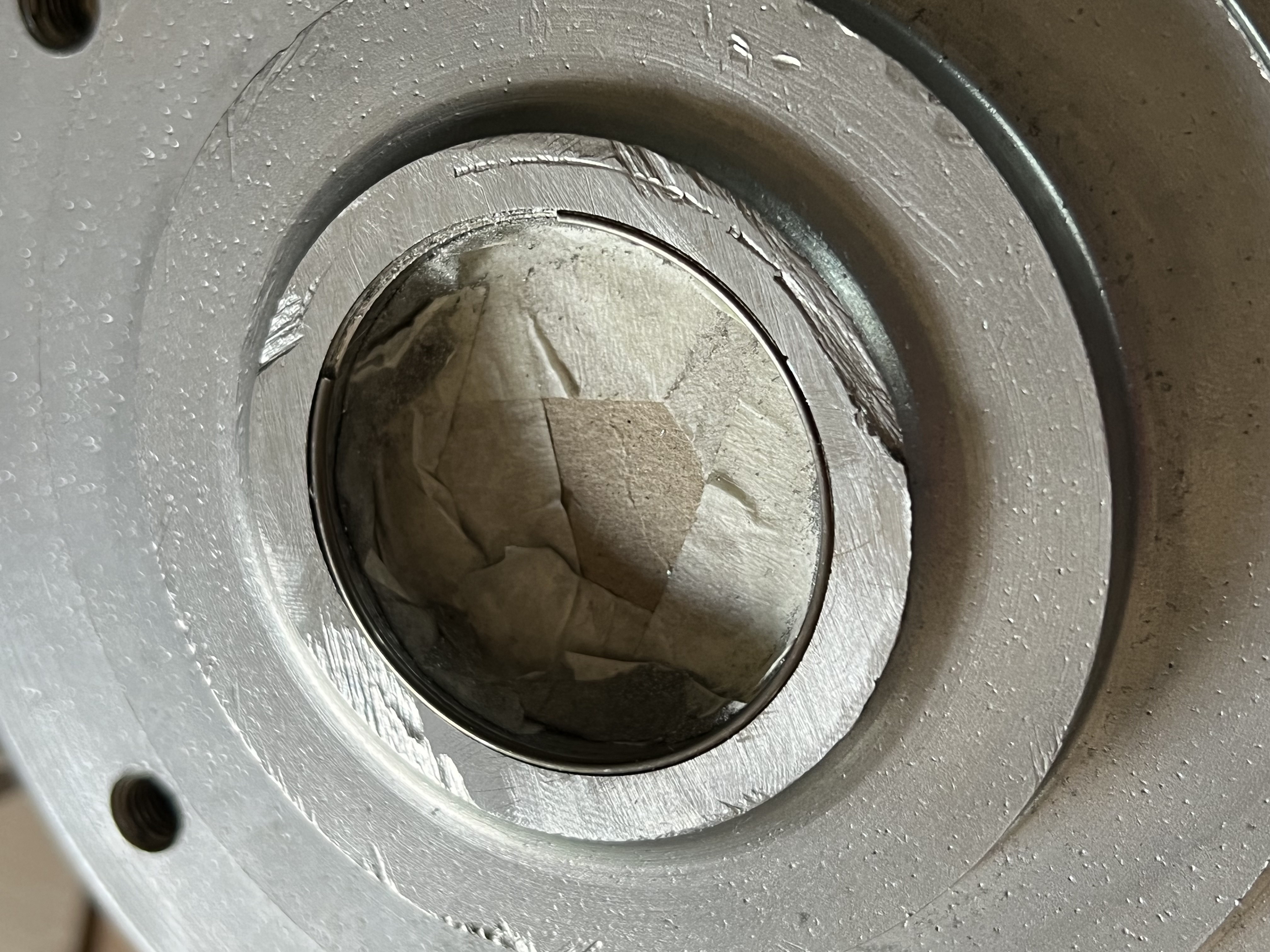

My repair solution to restore the circlip groove. I removed as much material has I could to level the surface without losing the groove.  Then made a plate and drilled/tapped holes for M3 screws that will be retained with loctite.  Now I can finally get on with reassembling the engine
