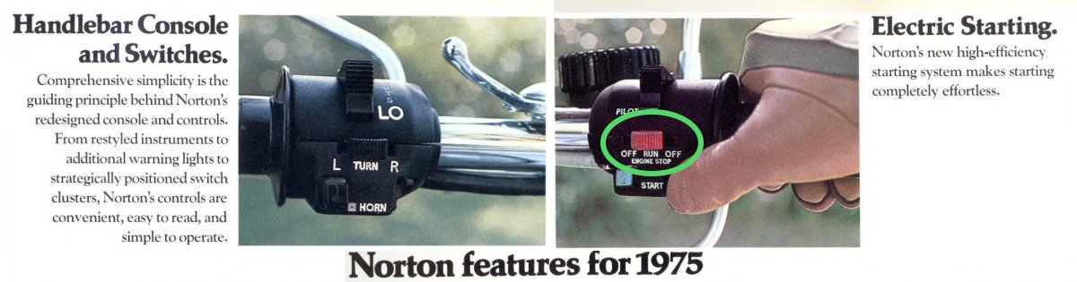

You have the kill switch on!
When you press the button is bypasses the kill switch and ballast resistor as mentioned, so it starts.  As soon as you release the button the engine will stop.

Please before you do anything, check the kill switch. The symptoms are spot on for that.
If it worked when you put it away, then that is the most likely problem.
Totally agree with the diagnoses already stated!
I also think your issue is with the off/run/off switch.
Switch
