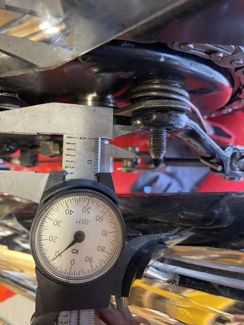

I thought I would do a little experiment. The lever return spring works in concert with the two brake shoe return springs. The lever spring is pretty weak; the springs on the shoes are very strong, so I wondered if the lever would return to its neutral position if the lever return spring were removed. The answer is no! With the return spring disconnected the brake shoes pull back from the drum but the lever doesn’t quite return to neutral without the additional assistance.
To your point about the cam shaft I removed the nut that secures the brake lever to the brake cam shaft and measured the length of shaft/thread protruding through the lever.
As you can see it was a shade over 0.6”. No sure if this helps you but when I tighten the nut to the recommended 30ft lbs mine moves freely.

Thank you for your comments. I also remember the brake pedal pogo stick story! There never being a moped rider around when you want one I have made do with a bunjee cord and the brake arm now returns to its stop. Success! As to the arm binding on the torque arm, I stripped the whole thing down again and found the large nut which attaches the tube to the backplate was loose to the extent that I got over a turn on the thing without difficulty! The result is a brake arm which no longer binds on the torque arm because the cam bolt can now extend far enough through the backplate. Now it all works perfectly. I can honestly say that in just over 40 years of ownership , this is only the second occasion I have felt the need to remove the rear drum - although this "occasion" was actually four times....Now it all works I shall certainly be using the rear brake more in future. Thanks again.
