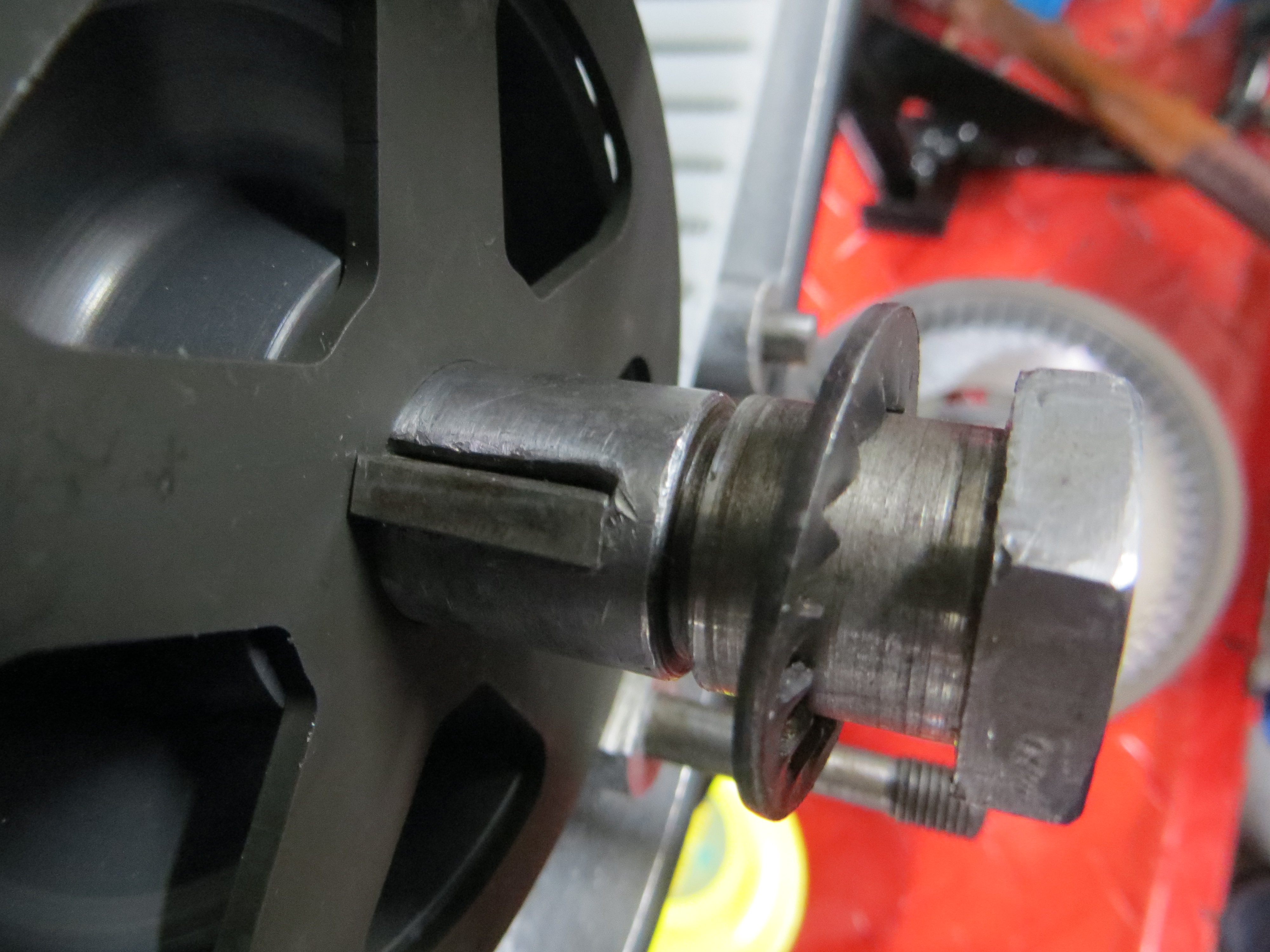

When I look and measure the crank key way, the key and rota...
Key and rota match at 0.158'' and 0.159'' - the key slides in the rota snug.
The crank key way is the issue - at the bottom of the key way 0.161'' but at the top 0.198'' and the key when placed in the crank key way rocks from side to side.
So it looks like the rota has become loose on the shaft and worried the crank key way making it now a sloppy fit for the key.
Is this something to worry about - or just get it tight to the correct settings and it will be OK?
Attached photo of the key in the crank shaft key way slot - I pushed the key to the left, you can see the 0.030'' plus gap on the right hand side.
Thanks - Paul.
Sorry Paul, I missed that you'd posted a photo, in which the felt washer can clearly be seen! That keyway though, ow! I've no experience with that kind of issue, but maybe you could make up a key, 'stepped' so it's thick enough for the keyway but thin enough for the rotor? Or make up a shim to take up the gap in the keyway? I expect someone's had experience of this though, and might have a better idea … I'd be very worried about the rotor hammering again if I just did it up and hoped for the best. I can't remember what the manual says about that shake-proof washer (or if it says anything at all), but from memory I've replaced it frequently – I'm not sure how effective it is when re-used, anyway. HTH
Thanks Colin - yes I have a new washer ready to use.
I like the idea of making a specific key that fits the worn key way - is that the best way forward?
I guess the timing using a strobe on the degree disk primary cover could not be relied upon, as the marks on the rota may be out a bit - that can be resolved using a timing disk instead.
Thanks - Paul.
You're probably aware that the degree marker inside the primary cover is unreliable anyway …? Unless it's checked and then left undisturbed. Twenty years or so ago I installed a 180 Watt alternator on my MK2A and found that the new rotor interfered with the degree marker, so I ditched that and scribed suitable marks in the resin of the stator instead, it works!
I have a home made stepped key on my Dommie shaft with no problems.  The crank slot widened out because the bike arrived without the correct split washer below the rotor fixing nut, and the rotor came loose, and started to rock about.  In doing so, it made a horrible noise and destroyed the stator.  You don't want that!  It's given no trouble ever since.
If the key is not snug, it's bound to loosen the nut eventually.
Just a thought here but why not order another woodruff key and grind it down till it fits the slot. Sort the timing with the bike running.
Thanks again all.
I also asked Norman White about the issue and post his response, as I expect this will be useful to more than a few of us....
Hi Paul. I take it that is the gen. rotor keyway. Not much to worry about as it is there to position the rotor correctly to aid strobing the ignition. What you must do for accuracy when timing is to do what I do with bikes that I have not seen before, and that is to check and correct the degree plate inside the outer c/case. You need a degree disc and  attach it to the crank in such a way you can release it without allowing the crank to turn. Fit the key and rotor and torque it up with a little locktite.  Find TDC with a dti or bar set so you can rotate engine forward and back to split the reading. Set the d/disc to TDC and rotate backwards to find 31 deg. or 28 depending on ignition system. Don't forget to rotate forward to the 31 or 28. Then take off the disc without allowing the engine to rotate and bolt the outer case on. Then check the timing mark line on the rotor against the degree plate and you can then adjust the deg. plate if it is screwed in place or if riveted, scribe your own mark to coincide with the line so you can use the scribe mark to time to.
