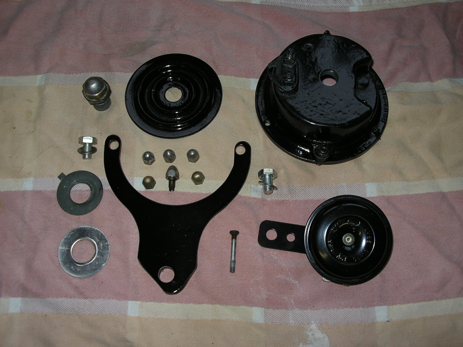

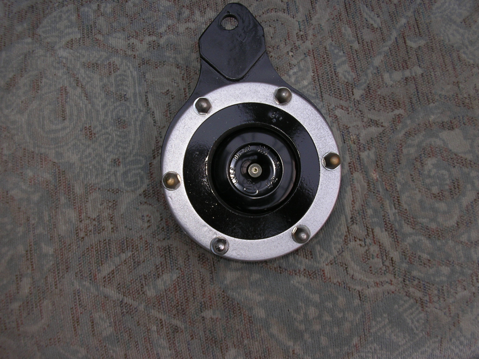

By coincidence, just 2 weeks ago I dismantled and refurbished my very dead ES2 horn. I needed to uprate it to operate at 12 volts and not kill the battery each time the noise button was pushed.
It is not the easiest of bike chunks to dismantle and I only worked out the proper procedure after adding more damage to the already very corroded and broken internals.
There are people who can rebuild these horns......at a hefty price......so I took the easy option instead of buying a cheap scooter/moped horn. Then, wanting to challenge myself I removed most of the original internals to provide space for the new horn to fit inside. Of course, on reflection I could have just mounted them back to back but that is too easy. My efforts have been rewarded with a very loud horn that now operates on demand.
Attachments show start and nearly finished points.
