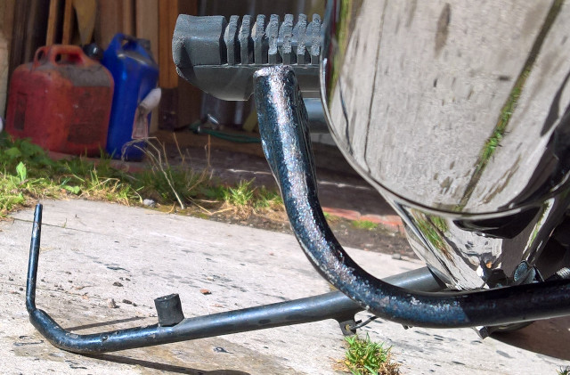

On the subject of ground…
On the subject of ground clearance, if you're touching the centre stand down then there's a lot of room for improvement by reworking the bend in the arm, even allowing for the silencer flapping around in the breeze:

definitely over enthusiasm on my part, the springs seem ok and only real problem is trying to ground it consciously, to investigate further. I am learning (leaning) on faster, longer corners now eg to keep over to the side of the road to see further into the bend, but now chicken out on my roundabout for grounding! Plus sorted clutch slip (actually read Haynes again) which adds another level of performance to enjoy this superbike of the back roads. New 19" front first. Thanks for responses and enjoy a nice autumn!
