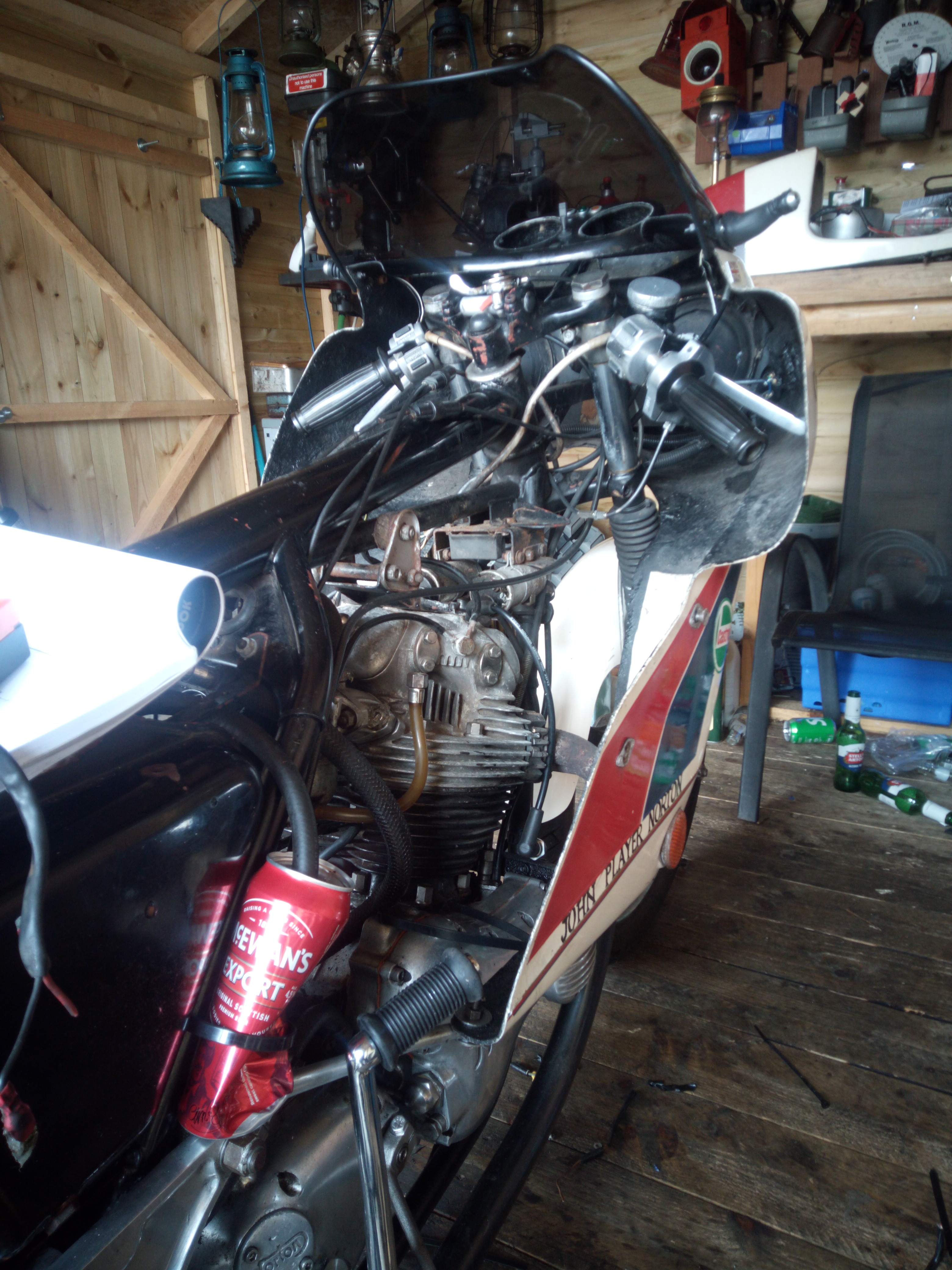

After fitting a Tri Spark charging system to my ex Interpol now JPN replica 1972 750 Commando, and seeing the state of the wiring, I decided now's the time to sort it out. Sent away for RGMs wiring loom kit, and although electrics is my weak point, I'm determined to give it a go and be back on the road soon. Does anyone have any advice or tips that'll keep me right?
