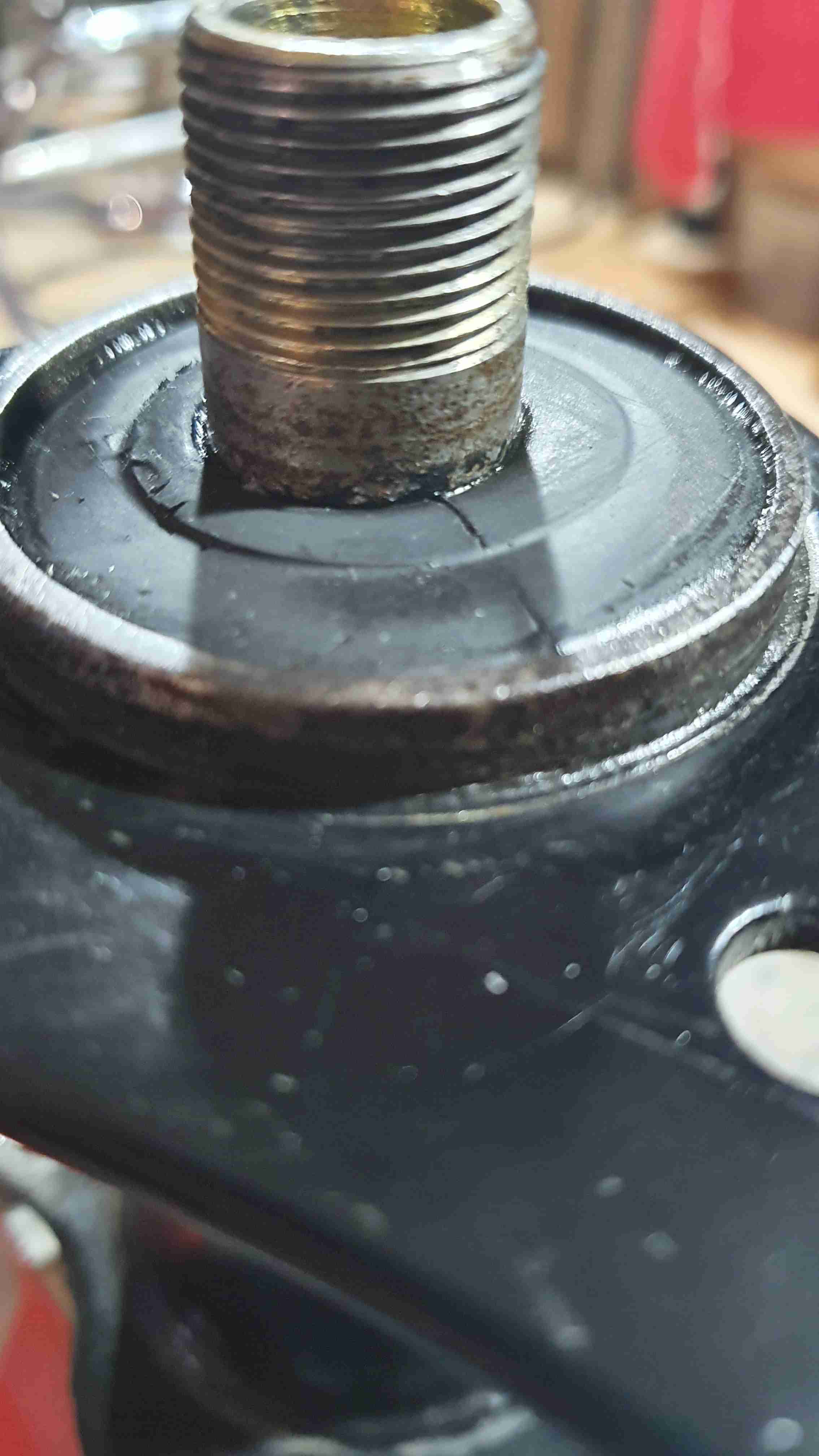

She got really shaky after I had installed a new RGM isolastic rubber unit. As I could not get used to the idea that somebody is selling something that doesn’t work, I spent weeks to study the ideal parallel installation of the engine in the frame (it is not possible, but you know that). But: Even if RGM claim they “have sold 2000 and never any complaints” – their piece simply does not fit, it is a piece of ... !
Where are these 2000 riders ? I didn't know we are so many. This post goes to them !
I should have given up when it was almost impossible to squeeze it into the tube, using heavy tools to push it really hard, special silicone oils of different makes, etc. But you know how it is, you want her back on the road ... now. But how should that work, if the rubbers are compressed so heavily, even slightly bent (see picture, it is hard to picture it but this rubber should be straight flat). The whole thing gets so stiff, how would that ever swing with the engine ? That is certainly not how the Norton engineers had designed this beautiful invention.
When I finally opened it, I understood the problem. My correction was to drill a few holes (8) with a 5mm drill around the middle circle of the outer rubbers, leaving them inside the tube. Took me 5 minutes. You can see and feel how the rubber relaxes. I mounted again (for the 10th time, at least, I can do it now in 3 minutes), with minimum play this time, just enough that the large washer can move freely. And what an experience – all the vibes gone, just as the inventors meant it to be. So smooth, I almost had forgotten. So, it is 100% waterproof that these RGM iso-rubbers are wrong, I think they are simply too big, about 2 to 3 mm in diameter.
However, this is only my personal answer, not the solution. And I do not know how long this will last. The real solution is: Buy whatever you want from RGM (they have a lot of good stuff), but don’t buy this. And, sorry to say, don’t listen to their advice (at least since recently). If they only would admit, yes, ok, we do have a problem here ... how many hours could I have saved.

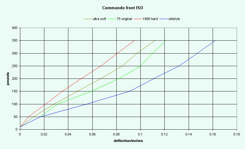

While I'm writing, thanks to David Comeau for his fascinating chart. The maximum load applied is very nearly equal to the total dry weight of a Commando.
Firstly, my big thanks to…
Firstly, my big thanks to David for this super interesting graph, which only supports the strange variety of this vital part of our bikes. I can only repeat my recommendation to have a close check before installation.

Interesting information on the stiffness of Isolastic rubbers. Probably goes some way to explain why the new Mk3 I rode was sooo much smoother than my Mk2A. Well that and the sprung heady steady and general overall newness.

Those were the main subject of my chart measurements shown above.
