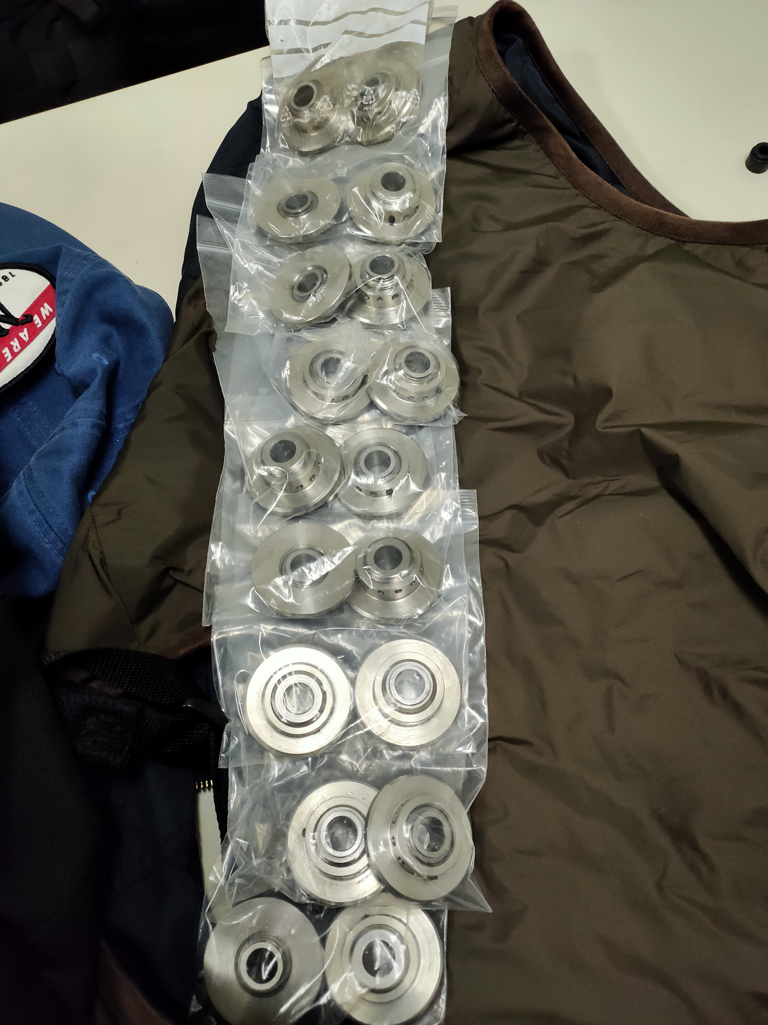

Mick and Angela have given me allowance to produce some sets, which he received samples and given his ok as for the quality concerns.
Interested might contact spanish NOC Branch
