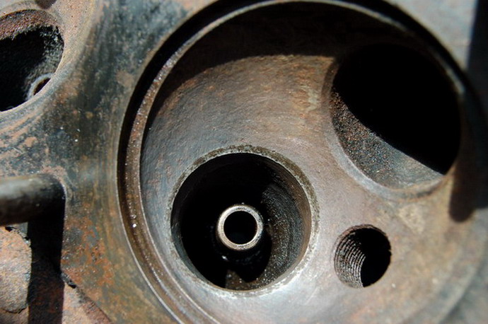

Hello Les,
I'm sure most Dommie owners will have a few iron heads kicking around.
I've just spent 1/2 an hour rummaging & am attaching a photo with this message. I hope it is clear enough to answer your question.
Paul

Hi Paul Very many thanks f…
Hi Paul
Very many thanks for taking the time again to answer me so comprehensively. I am very much obliged.
Your personal iron head photo is very encouraging, showing quite fine valve seats and pretty smooth ports too. I notice theexhaust port on the top left is obviously coked up and is not showing the underlying finish.
I had imagined that somehow the iron heads would have a very rough, poorly shaped ports with no finishing, and just cast holes,but they seem pretty good, I've seen much worse on alloy heads, not necessarilly Nortons ones though. Another thing is that I recently read the iron heads had similar valve sizes for both valves, but your pictureseems to show a larger inlet valve as per Alloy versions. I hope I find the same in my one.
The webpage is excellent,I'llbookmark it. It is a very informative reference, which I will find extremely useful.
I note that it says early iron heads did have similar valve sizes, so it seems your iron head is probably a later type?
I hope my onedoes have the larger inlet valve size. Just noticed the iron head shown seems to have been sprayed silver and looks initially like an alloy one!

Hello Les,
First off, the head in my photo has been amongst my stash of bits for around 30 years. I remember shifting it around now & again & thinking it was just one of those old relics which I would never use. Now I am on the learning-curve, with the recreation of a standard 1954 88 DeLuxe. That means parts I own like this are in the queue for renovation.
Iâm really looking forward to seeing just how smooth it will be, with everything to original specâ, right down to the 6.7:1 compression (depending how much has to come off the joint face!). So unfortunately that head wonât be for sale.
I should explain that when I took the photo yesterday, I sploshed some diesel around one inlet seat and gave it a scrub with a plastic scourer. I wanted you to be able to see that there was no seat insert. Also, the photo was not taken with a small lens and I took it up close and in line with the inlet valve guide; so with the exhaust valve seat being closer (therefore altering the perspective & making it look larger) that created the illusion of different size seats, which is not the case. I donât believe there was ever an iron Model 7/88 head with larger inlet valves. Unless there were factory, experimental ones. I do believe Norton had developed an aluminium alloy head for the twins, by around 1950; but it was only to explore what potential there was with racing in mind.
If you must get more squirt from your Model 7, I think you would be better off finding one of the later heads for it. No problem at all with unleaded fuel while you tidy up the iron head. It would handle like a truck though, with that plunger chassis. I would leave it be and just waft around on it.
