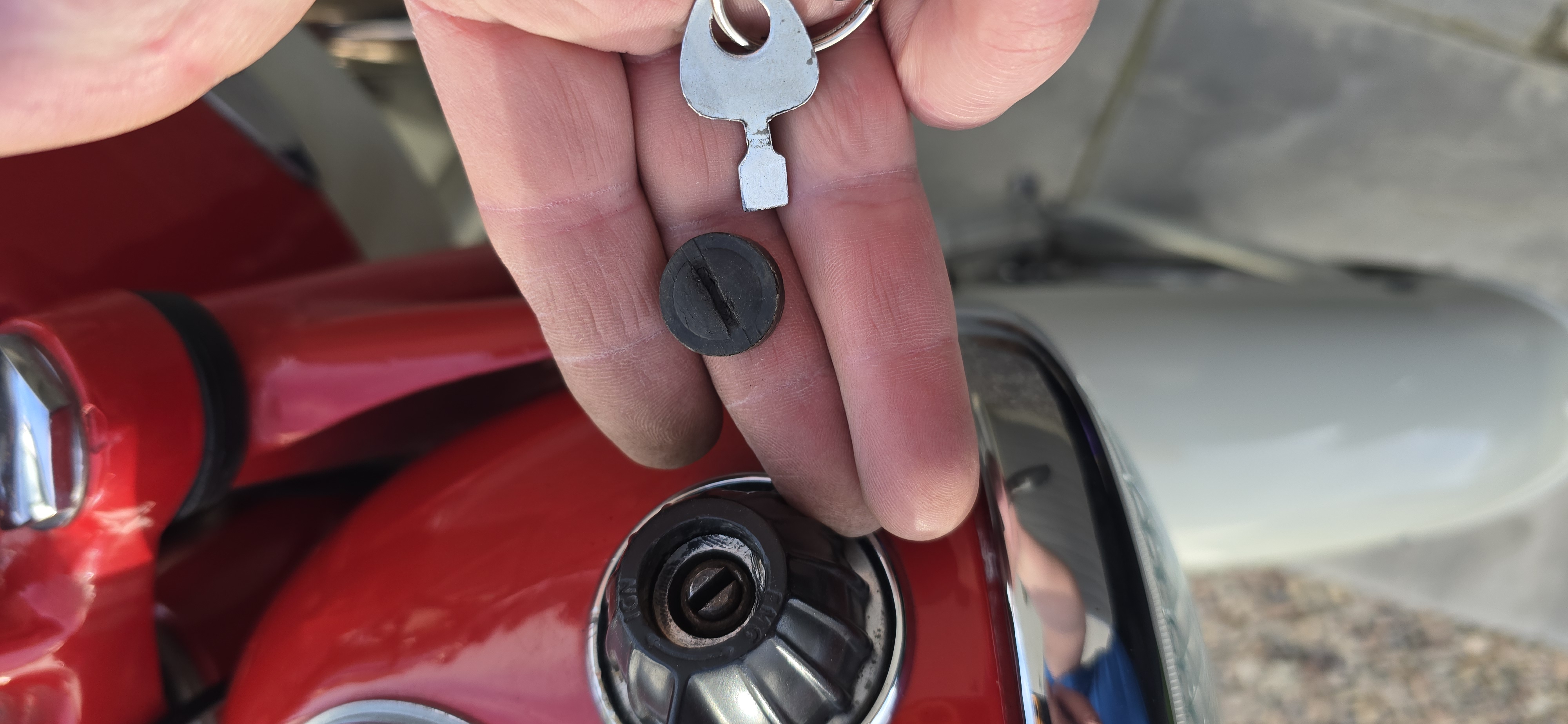

Is it possible to buy new rubber seals, grub screws etc?
Mine vibrated off today - luckily fell into the space behind the headlight so was able to refit once I found an Allen key that fitted. However the rubber seal is really brittle.
Can they be sourced anywhere? Had a good look but found nothing.
Key and Grommet for lucas PSR8
ooh thanks will take a look
found the part number so for future ref it Lucas 318323
TRY
Try Greystone enterprises 01262799. They mostly do a lot for Triumph Tigercub, and this switch was fitted to them. The original switch knob was held on by a BA threaded bolt with another screw in its centre that spread the first bolt to hold the knob still. The original of these rusted up, and the replacement never did have the expanding screw, so it became a plain screw with a long shank, and the knob rattles. aoservices.co.uk has details on servicing the switch.
I recently bought online from Feked Classic bike spares. About £5.
