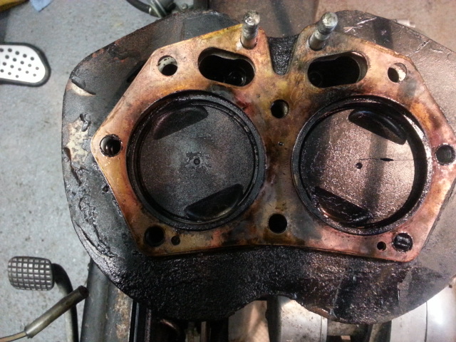

Hole in piston

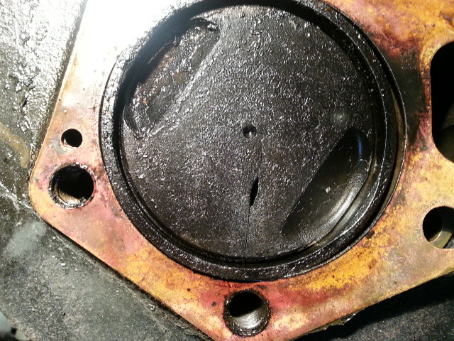

This happened after a couple of minutes at 70mph some years ago. I blamed preignition at the time, but I heard no pinking. It permanently knocked my confidence in the bike. But there is no sign of preignition burning the carbon off the piston. Vincent's 'Tuning for Speed' says the piston opposite the plug will look as of the mice have been at ot. But it's not like that.  I think the crown was too thin. Any views? The undamaged one has no sign of burning. The damaged one had a heavy dose of oil when it failed.
Thats interesting, I think you are right , a thin top, perhaps cracked first then burnt thro the crack.What make pistons?, Look as if they have been worked on a lathe ,maybe skimmed off the top?.
JP pistons. I found a hairline crack up from the pin in a previous one a couple of years ago. I don't believe it was pinking. Electronic ignition set by hand and tested by strobe, and never hear any knocking or pinking. I am familiar with the sound! It's an 88SS on +30, for which pistons are hard to find. I have a pair of NOS Heppolites low compression ones. I should fit them to be doubly safe.

In this case I blame metal fatigue. Many thousands of stress cycles, all inside the strength of the material, but damage accumulates.
My Heppolite piston crown thickness: 6.5mm. The JP piston: 4.3mm.
Since stress is proportion to the square of the inverse of thickness, a 50% bigger thickness is less than half the stress, and maybe Heppolite could have 8 to 10 times the fatigue life.

Maybe I shouldn't be to hasty in entirely blaming JP.  The first piston problem was within a year of fitting a full flow oil filter. I think it is underlubricating. There is damage on the front and back faced of the problem piston. I assumed it followed the hole...but that makes no sense. There was oil everywhere as combustion pressure blew it all over the place.
It's time I removed the barrel and inspected again.
I have had 3 similar failures over the years, 88, 99 and Atlas. With the 88 and 99, a piston cracked and then holed. The cylinder kept firing and the combustion flame torched the small end of the rod which opened out and let go. The cause on the 99 was an asymetric mag cam ring and over advanced ignition on one side. With son's 88, it was cheapest low octane unleaded, 2 up on a very hot day on the autobahn so the engine was cooked and both piston crowns collapsed then the rod let go. Pre-ignition probably. With the Atlas, no obvious cause. A quick rebore and all was once again well.
Dave.......there is a 99 left-hand piston for sale on eBay this week. It is 68mm + 30"in very good condition with a £30 price tag. The downside being it looks like the make is GPM.
Thanks Phil. But I think I'll fit my NOS Heppolites. They are low comp. That should give comp ratio 8.5 instead of 9.45. Should be plenty, and safer.
I have a full flow filter. But that is on return side. If it constricted flow, the symptoms would surely be wet sumping when running? So many options!
