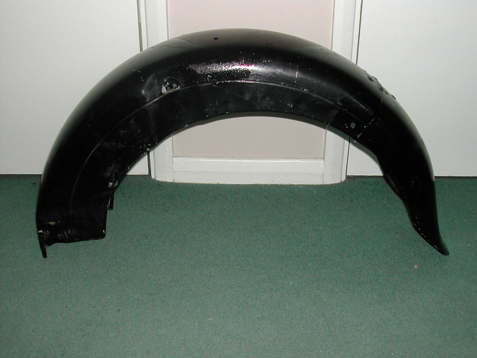

I have spent many years on the lookout for correct original partsto fitthe '54 featherbed DeLuxe and they keep turning up. Thank goodness. I've always found Bacon's books justrecite theoretical factory data andbrochure images. Also, most ofhis photos seem to be of restored bikes.
I'm attaching a (fairly poor) photo of an original, one-piece rear mudguard which came from a March '54 88.
Paul
Attachments Norton-88-D-L-54-one-piece-rear-guard.jpg- Log in to post comments
Hi Paul, Yep, that looks a…
Hi Paul,
Yep, that looks about right! My Dommy 88 was first registered 29/07/1954. I am now living in Spain, so, can't get to autojumbles. If you know a source for the correct carb & manifold, for a '54 88, I would be most interested (my bike has a monoblock, which I suspect is from a later 99)
Regards, John.

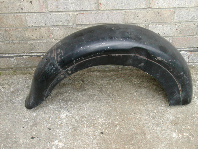

If you have a copy of Roy Bacon's book on the Norton Twins have a look at the half title page (page 3). According to the write up this was taken at the 1954 Manx Grand Prix. This is a 54 patternmudguard as it has the open frame numberplate whereas if it was a 55 it would have the boxed in type.I would theorise that they changed later in the model year to enable the use of the tooling used on the single downtube model (pivoted fork) frame. These twomudguards are virtually identical apart from the featherbed type being 3/4" shorter at the front plus different hole positions.
I have a 55 model 7 guard (NOT for sale)and one for a 55 88 so I can do a direct comparison. Also interesting is the fact the grab rails for the Model 7 carry the same part number 53 to 55 yet the catalogue images for 53 and 54 show something that does not relate to those actually fitted. Theattached picture, a New Old stock Model 7 mudguard for 1953/54 models.
To those of us without the luxury of having the original catalogue (s) see http://cybermotorcycle.com/gallery/norton_1953/there is quite a collection on this site.
Jim
Attachments New-Old-Stock1.jpg- Log in to post comments
Hi Jim, that photo (N-O-S…
Hi Jim, that photo (N-O-S 1) looks like the one I had on my 1955 88 - from memory anyway. I am also fairly certain that it had an open frame rear number plate. All long gone, sadly. The problem with Norton parts lists as anyone who, like me, has a collection of them knows - the illustrations were not regularly updated. As an example, the 1959 88, 99, ES2 and Mod 50 parts list shows an earlier front brake plate and spindle andan earlier swinging arm with the forked ends rather than the forged ones that were actually fitted. Even their owner's Maintenance Manuals had outdated illustrations. It means that periodphotos are often the only true way to find out what was fitted and what they looked like!
Cheers, Lionel

Hi all, I'm going to clea…
Hi all,
I'm going to clear up the mystery here.
It NOT off a plunger ES2 which I might add they didn't make in 1953, they were swinging arm frame that year.
I have attached a picture of an authentic, genuine original Model 7 rear mudguard from a 1955 model made in October 54.
If your ES2/Model 7/19S of 1955 has anything other than this fitted it is wrong; this mudguard matches exactly the catalogue image.
Jim
Attachments DSCN1216a.jpg- Log in to post comments
