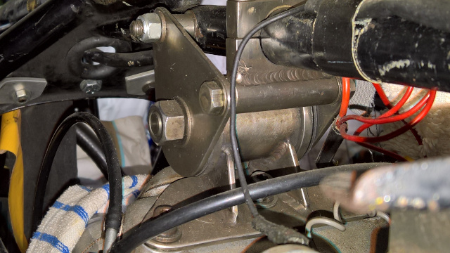

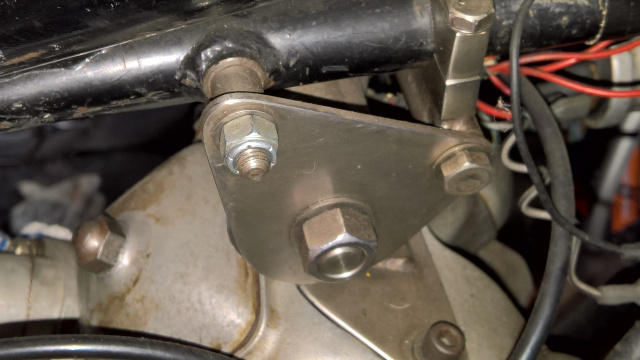

I'm changing my Norvil rep back to roadster spec, when trying to fit the (genuine tank) the head stay bolts/plates are very tight on the tank tunnel. I saw there was some info in some old SOC notes, if I change from the 1/4" alloy sideplate to 1/8" steel plate & mushroom head screws I think I might get away with it?
What do you think?

I'm quite happy with the way the bike handles, I can't see me having to modify the tank yet, I think with the 1/8 plates/mushroom head bolts I may get get away without the big knocking stick.

I have an original PR head steady bought from Gus Kuhn's over 40 years ago — and never used because it fouls a standard Fastback fibreglass tank.

I also have one from Les Emery, fabricated from stainless steel. Measures 63.7mm outside-outside of plates (versus 88.3mm on the original). Would that fit under your Fastback tank? Maybe use countersunk bolts instead of nylocs on studs. Do you a straight swap if you're interested.

Norman White used to offer a narrow 'Norvil' type steady that lacked the centre mounting, for fitting under Roadster tanks.
Personally, I prefer the rose-joint type that RGM offer, both in terms of smoothness and stability. I wouldn't go back to a 'Norvil'
The Mk 3 steady is simply the standard 850 box-section steady with two holes for the suspension spring device. It doesn't provide any extra lateral location compared with than the earlier 850 item.
An Interstate tank went over my Norvil head steady just fine. Both original Norton parts in the 70s. And I thought Mick's head steadys were a straight copy. But I have seen the alloy side plates replaced by thinner steel so maybe others have had clearance issues.
As for whether a shimmed head steady makes a difference, it depends on what you want from your bike. If you experience annoying wobbles, perhaps when loaded up, or a general vagueness, then you'll probably want to keep it. But I'd try the standard head steady and see how you get on before taking a hammer to the inside of the tank.
