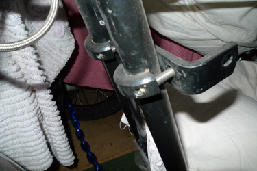

I have measured the downtube diameter on my Commando and it's exactly 1" when you take off a few thou. for the paint. That is not from a Mk.lll but I don't think they changed it at all.
You might find a steering damper mounting useful as the means of attaching your bar to the frame. The lousy photograph attached will give you the idea. Even if the height did not work out right, you could still use the semi-circular bits and the U-bolts with another base plate.
Attachments damper_mounting_s.jpg- Log in to post comments

Be careful, be very, very, careful.
I have seen the front downtubes dimpled in where the "U" of the u-bolts contact the tubes. There is not a lot of surface contact there and the resulting pressurefrom the contact points can cause the tube to be bent. Perhaps, a saddle of some sort under the U would spread the load.
