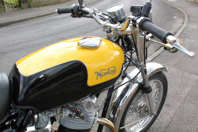

Hi - I faced the same problem a while ago. I ended up sending a photo copy of an original sales brochure to Fairspares asking which bars listed in their spares catalogue were the same as those pictured. The reply was:
HiThe handlebars are part number 065748regardsThese were what I bought and they apper to be identical to the ones I wanted. I have just measure them and they are 28".I have attached a pic so that you can compare against the bars you require.CheersPeter.Attachments
