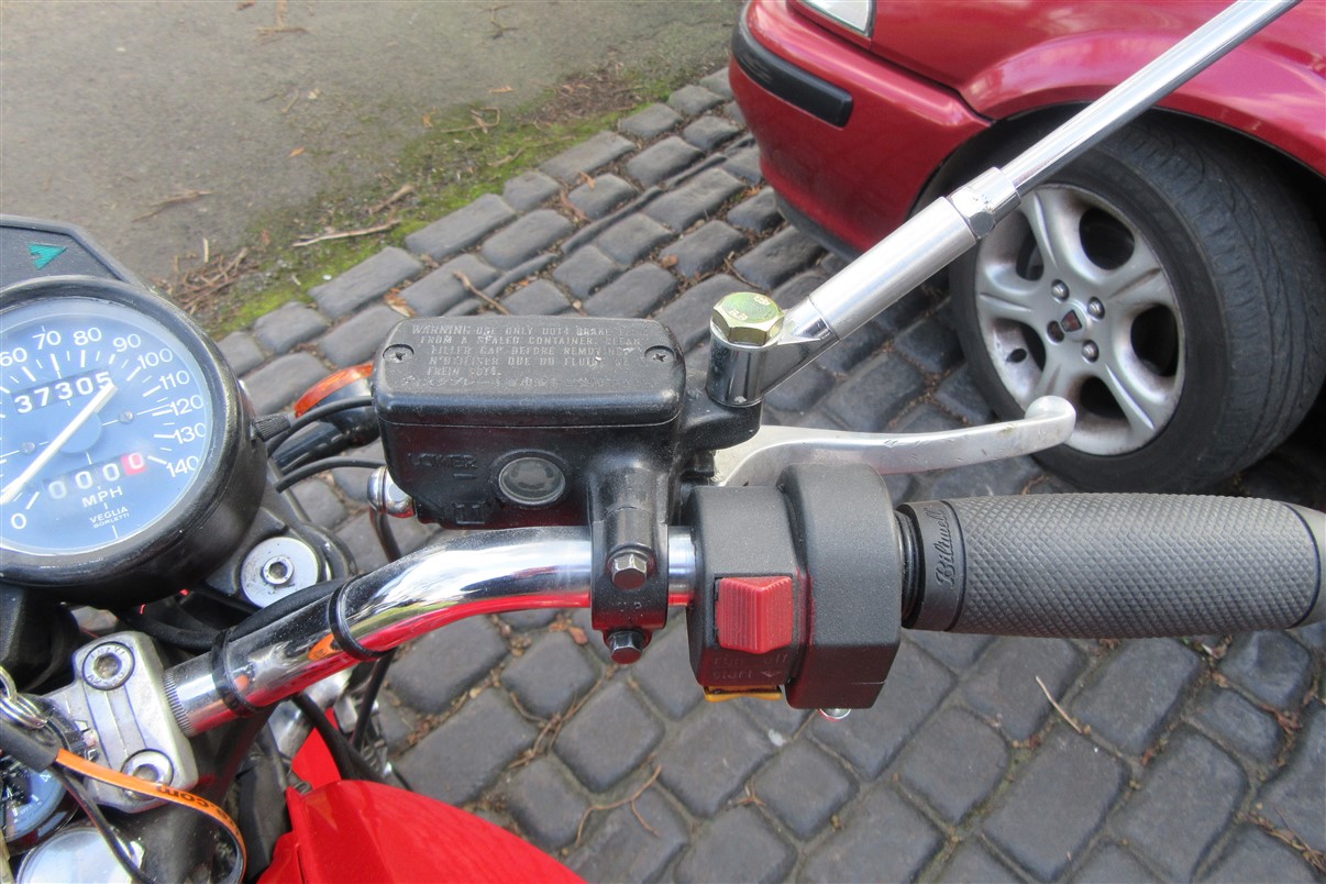

Hi Peter, I would keep the standard threads and look for a 20mm mirror that suits your purpose then cut the tread down to 3/8 unf so it will screw directly into your standard fittings, that's what I did as pictured.
Graham

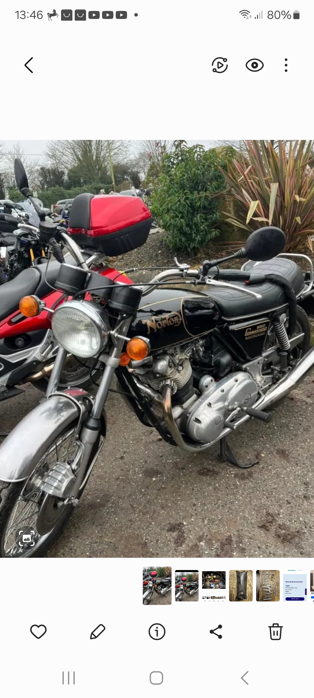

Thanks chaps for the response.
I managed to find a set of "Evomosa" mirrors on Amazon. (I hate that site but had to use up a gift voucher!)
These are similar to Graham's and can be adjusted to protrude horizontally. If I need to extend them there is a convenient joint I can make a spacer, similar to what Ian has done.
When the weather breaks I'll take the bike for a test ride and adjust accordingly.
