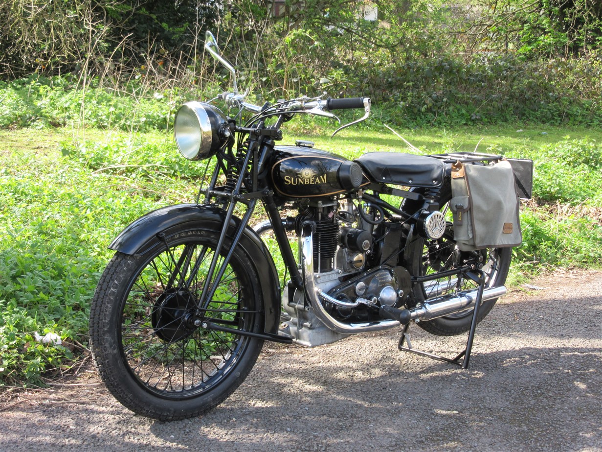

... Francis Barnett and it was fine although didn't like tight bends. I've also used the 3M masking tape and gold paint on my Sunbeam but the stuff I used washed off. Can't remember what it was.....

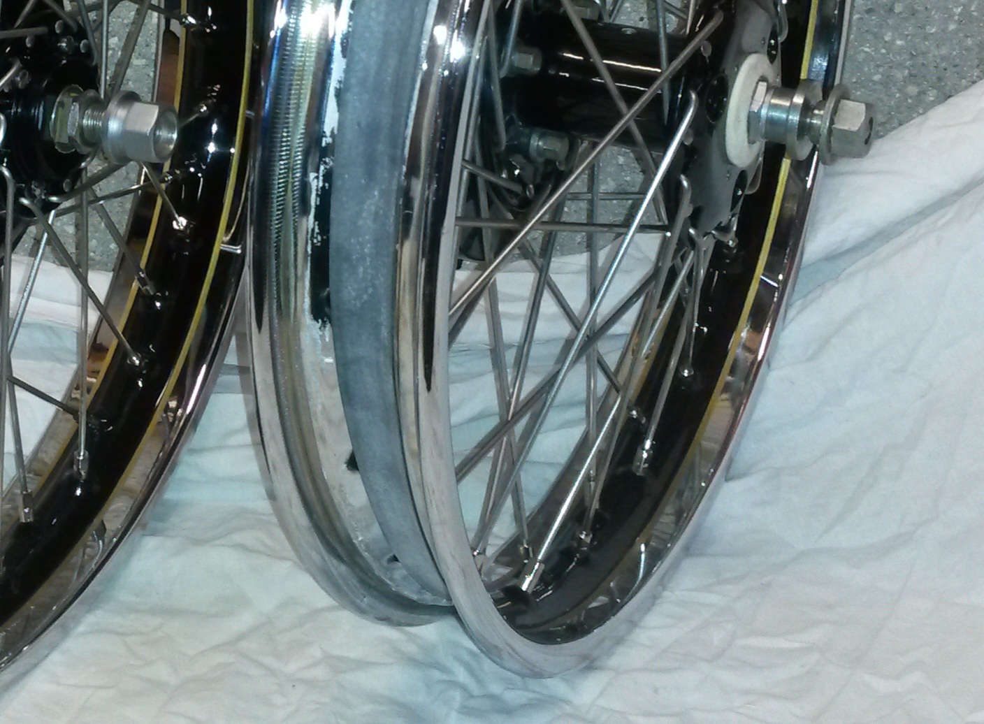

Another vote for 1 Shot.
Not the cheapest but good quality
I used this on my BSA wheels.
