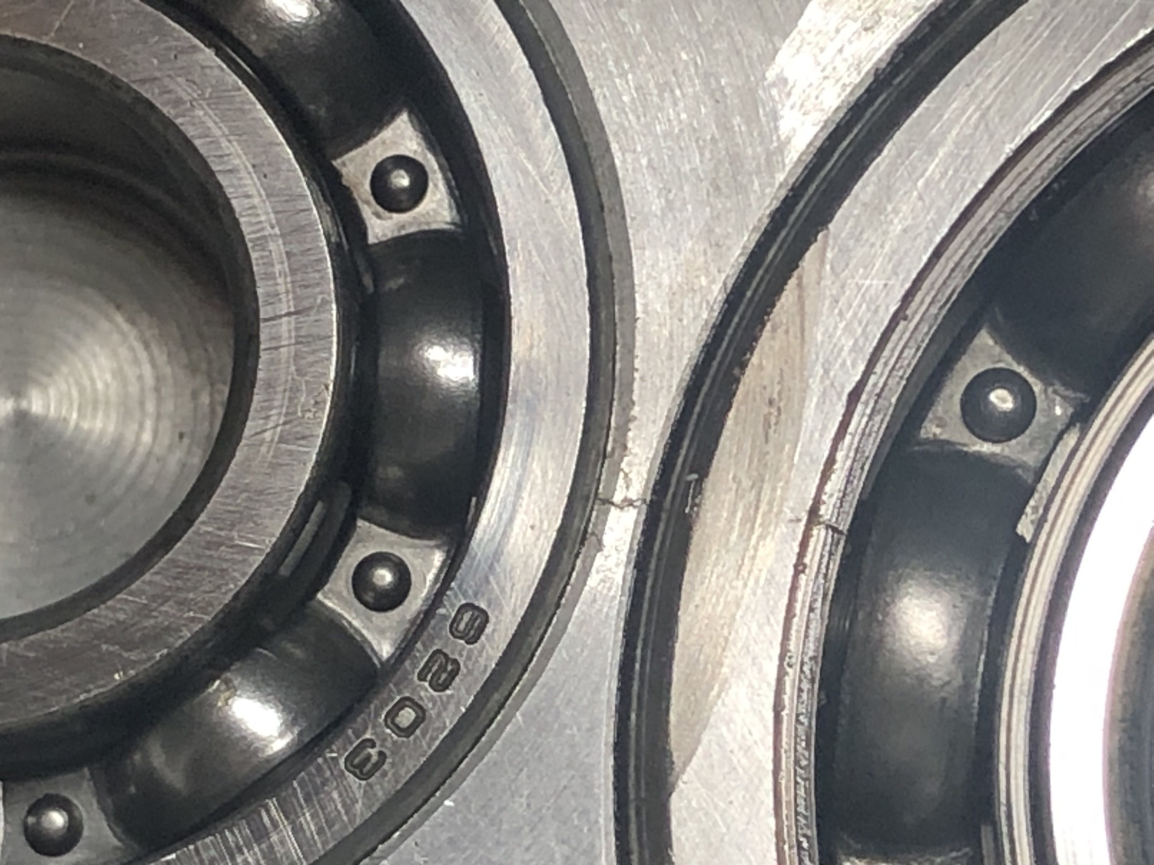

I've just taken my MKIIA gearbox apart and the first thin to address is the cracked shell. I could of coarse buy a new one or......... could I use a pre commando Norton AMC shell? - if so what were the changes introduced to the shells since their first issue?
Is it the crack just between…
The shell has cracked - I…
The shell has cracked - I gather that is scrap and loctite won't help that?
Ah sorry yes it's cracked…
Ah sorry yes it's cracked between the two bearings - do they crack any where else?
Do they crack anywhere else?…
Do they crack anywhere else? No. If the bearing races are still firm in the case and have not worn the holes oval etc, loctite will stop any chance of them revolving. Have a look at the outside to see if the crack has propogated through (unlikely) It is only this very thin wall that cracks. Does it look as if the layshaft bearing has collapsed at some point in the past? Have you removed the bearings? if so look at the surface of the bores where the bearings sit, Does it look polished? a sure sign that the bearing race has been turning in the bore of the case. If the bores still show machining marks the bearing have been held firm.
Is it the crack just between the bearing recesses? Has one or both of the bearings been turning in the shell?. Obvious by the polished surface caused by the outer race revolving. How slack are the bearing outers in the case? You can loctite the bearings in place if the case isn't worn. This is what loctite is ideal for.
